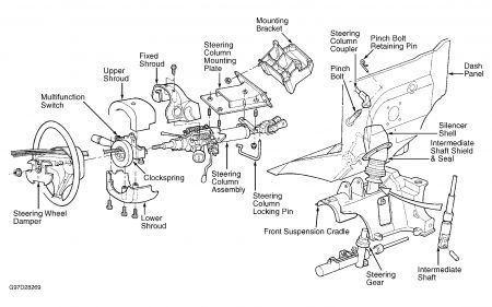

when i turn on my left blinker the right blinker comes on. when i turn on my right blinker my wipers come on and my headlight dimmer switch will not work.

Replace multifunction switch
https://images.2carpros.com/forum/automotive_pictures/99387_Graphic1_73.jpg
