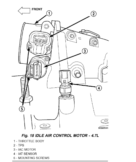

Truck is trying to die when sitting still. Runs great on the road.

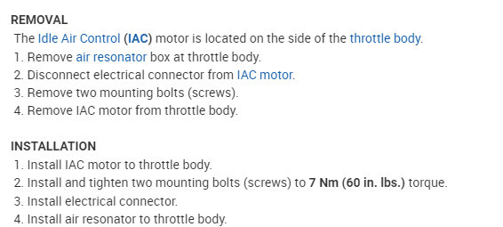

If nothing is found, suspect the idle air control valve (IAC) is failing. The IAC is responsible for maintaining the engine's idle speed and is located on the throttle body.
If you look below, I attached the directions for replacing the IAC. When you have it out, also confirm there is no excessive build-up of carbon where it goes into the throttle body. Before you replace it, I would suggest servicing it first.
Here is a link that explains how it's done:
