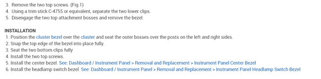

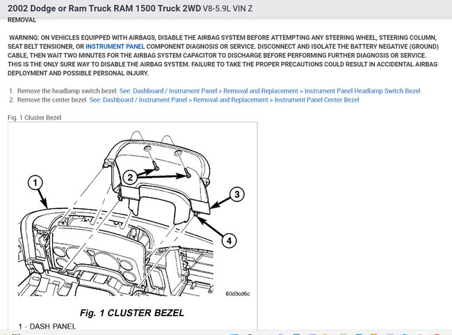

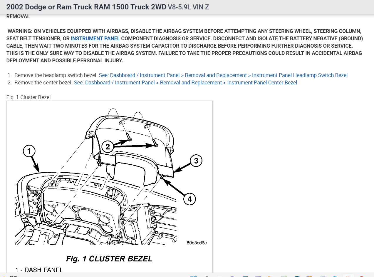

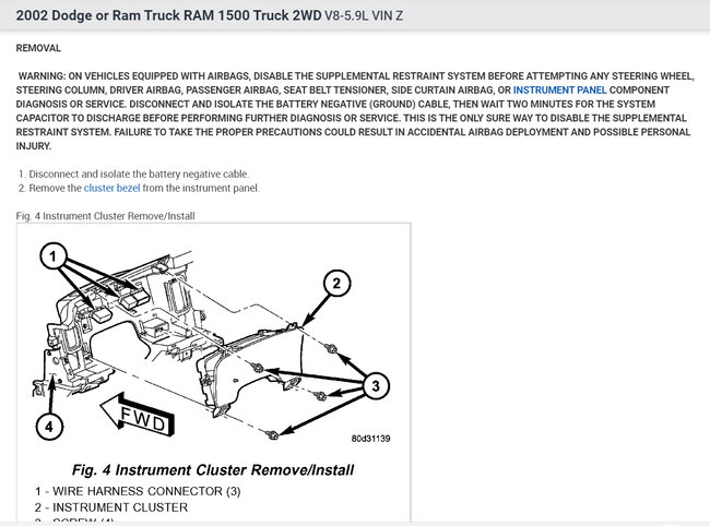

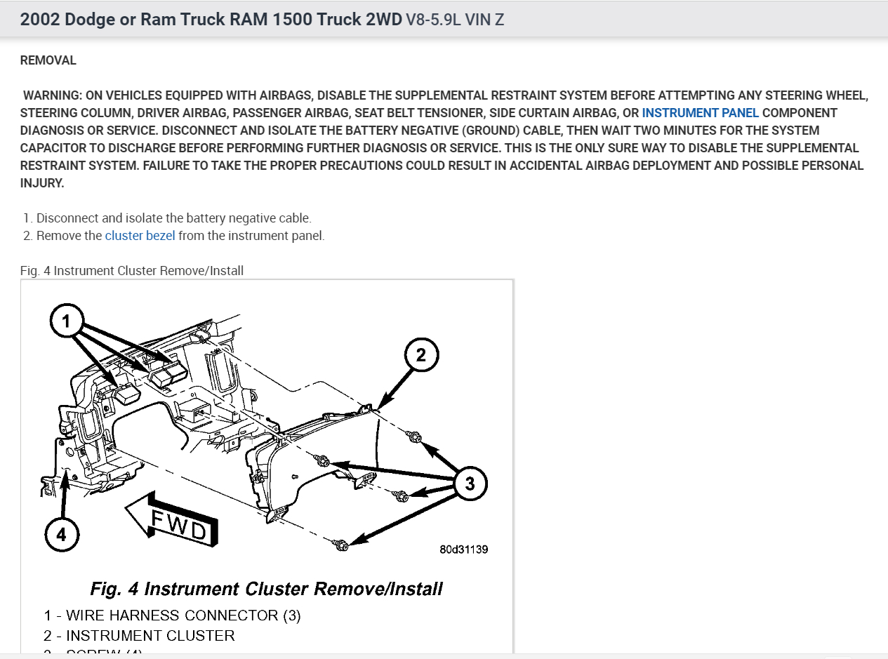

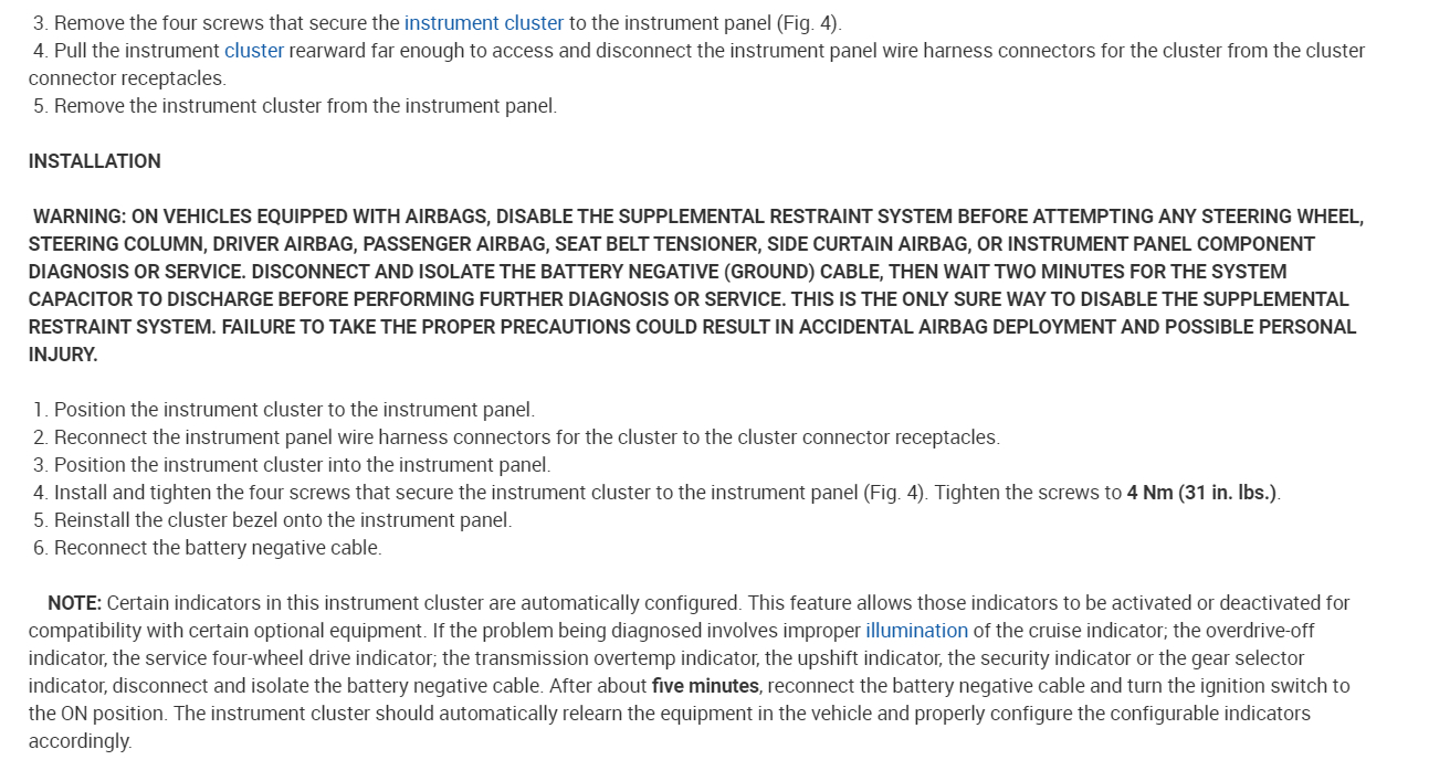

Yep, this is common when the instrument cluster goes out, it is easy to replace because it-self learns. Here is how to do the replacement and the location of the unit in the diagrams below. You can get a rebuilt cluster from eBay. Check out the diagrams (below). Please let us know if you need anything else to get the problem fixed.
