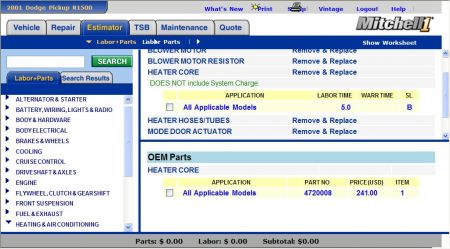

Water leaking inside on passenger side when heater is run. When the heater is turned on u smell a order like water hitting the exhaust and the windows fog up on the inside the truck.

Sounds like your heater core is leaking

How much of a repair job is this, a general ballpark figure ?

See quote below-Labor rate varies with location $70.00 -$130.00 per hr. Shop around
https://images.2carpros.com/forum/automotive_pictures/12900_heater_core_2.jpg
