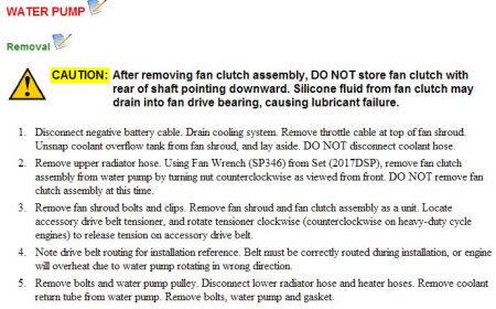

How do you remove water pump ? Problem removing fan and then the water pump! Please help and respond as soon as possible. Thank you very much.
