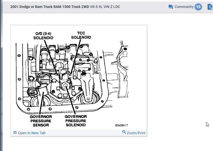

where is the overdrive solenoid located?
Apr 1, 2009 at 2:43 PM
BMRFIXIT
  • 19,053 POSTS

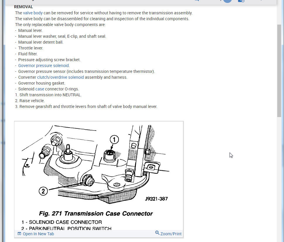

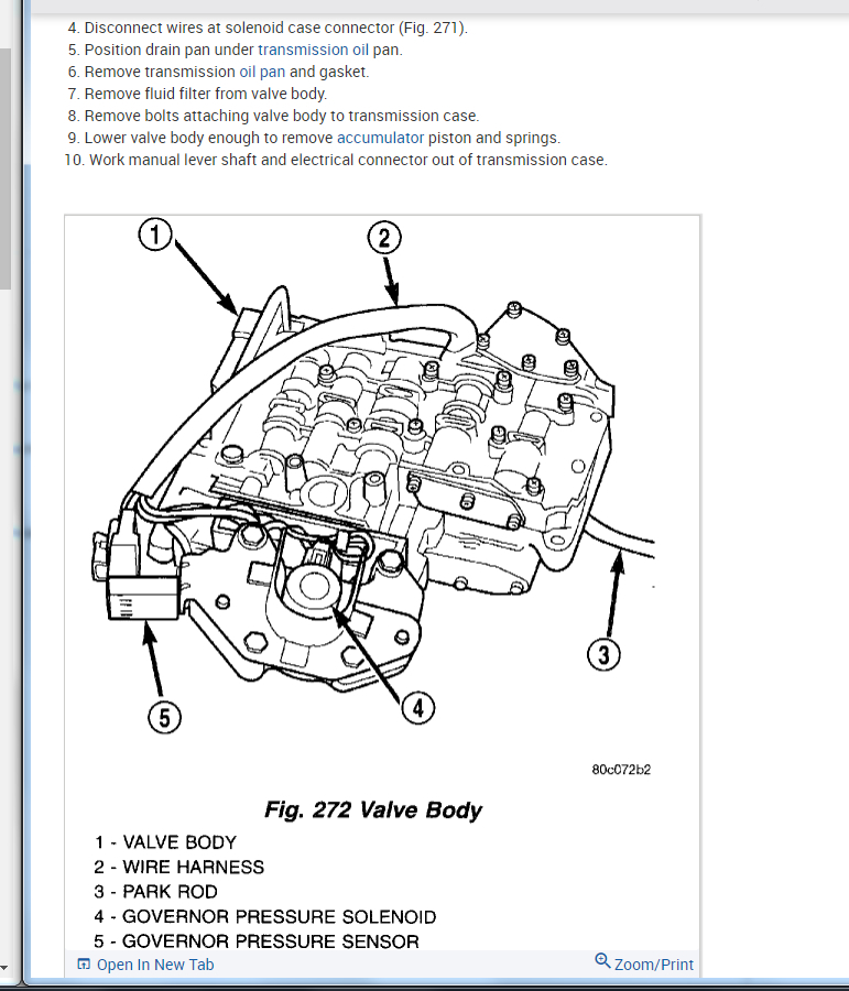

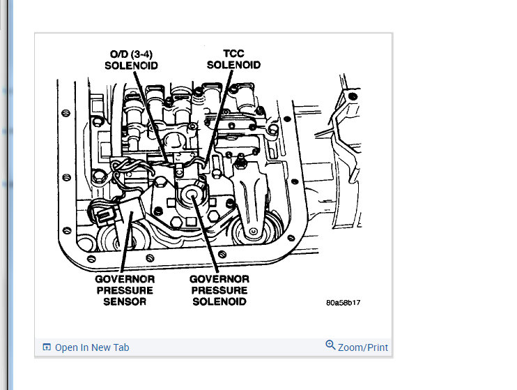

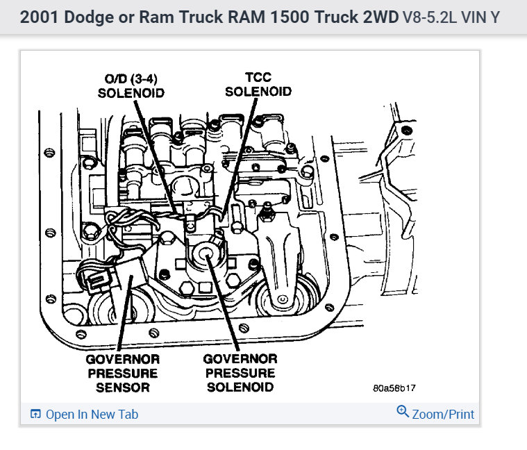

The overdrive shift solenoid is located in the pan of the transmission here is a guide to help get you started and the location of the solenoid in the diagrams below.
May 1, 2021 at 11:29 AM
Below you will find the process to not only locate the solenoid but replace it as well. You need to remove the valve body to do this so that is included as well.
Please let us know if you need other info. Thanks
