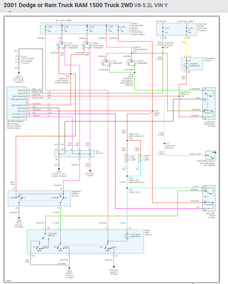

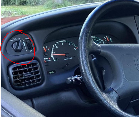

where exactly is the head light switch and how do I get to the wiring of it. I am installing a remote starter kit and part of it requires me to tap into the parking light wire. That is where I am stuck right now. Any help will be greatly appreciated!
Apr 6, 2008 at 10:21 PM
SQM
  • 6,383 POSTS
The headlight switch is located on the upper left corner of the dash, above the left vent.

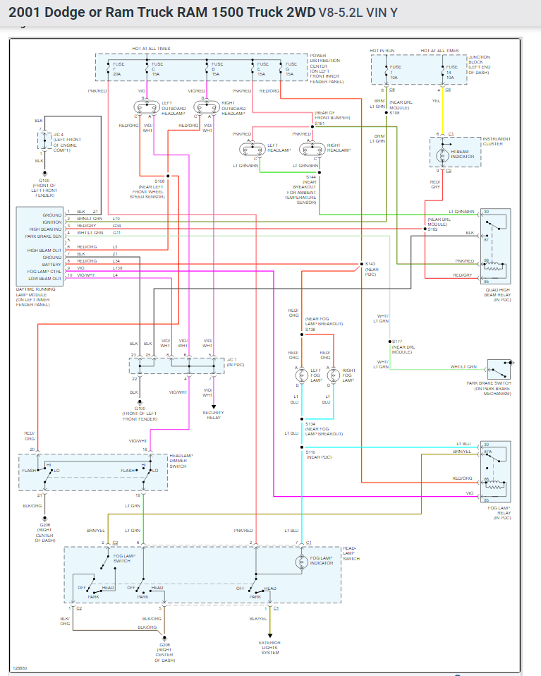

I have attached the wiring schematics for your reference.
Remember to disconnect the negative battery cable before doing any splicing, in order to keep the wiring protected and blowing any fuse.
