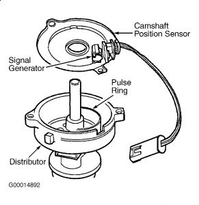

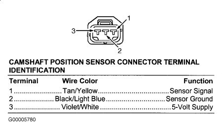

Thank you for the reply. I installed a new IAC and took the truck for a drive. The same problem persisted and another showed up, all accompanied with new codes. P1391 was indicated after driving just 50ft or so. I'll run down the wiring to the crank & cam sensors, followed by a crank tooth inspection if possible. With 172K on the engine, I may opt for a lower mileage pullout (backed by a gurantee) and simply replace the whole thing if I'm going to spend more money on sensors. The fuel pump assembly had been replaced about 1200 miles ago.

Connect scan tool to DLC. Using scan tool in MISCELLANEOUS FUNCTIONS, choose SET SYNC. The SET SYNC will indicate position of distributor for fuel synchronization, not the ignition timing, as ignition timing is controlled by PCM.
Follow instructions on scan tool and start engine. Warm engine to normal operating temperature and note display on scan tool with engine idling. If IN RANGE with zero degrees is displayed, let me know .
If a plus or minus number is displayed next to the degree number, distributor must be repositioned.
Loosen distributor clamp retaining bolt.
Rotate distributor until IN RANGE is displayed on scan tool. Continue rotating distributor until achieving as close to zero degrees as possible. Tighten distributor clamp bolt to 16 ft. lbs. (22 N.m).

code p1391 is an indication of troubled cam sensor check and adjusting the cam and crank to be in SYNC should be a 1st step 2nd need to check for if cam sensor is malfunction and or the wiring
https://images.2carpros.com/forum/automotive_pictures/99387_Graphic1_632.jpg
https://images.2carpros.com/forum/automotive_pictures/99387_Graphic2_298.jpg
