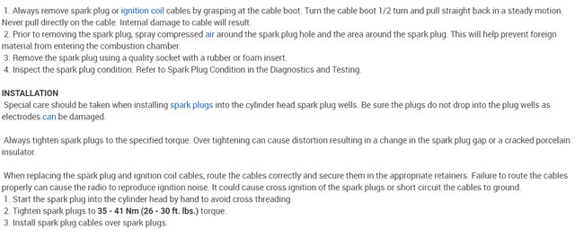

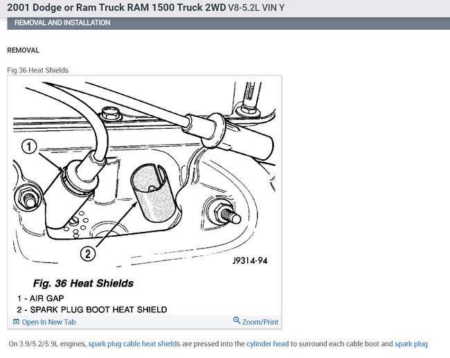

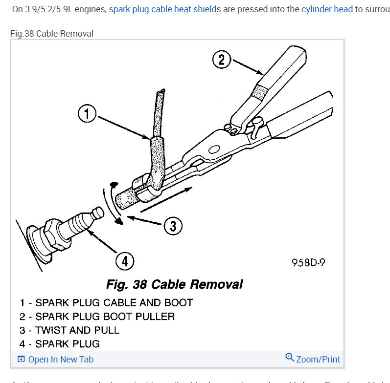

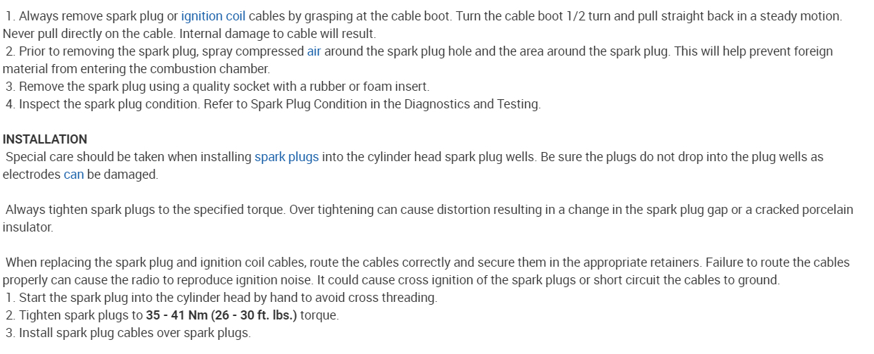

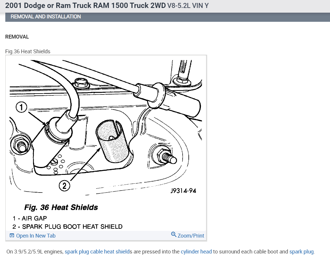

It sounds more like the engine is misfiring which indicates it needs a tune up.
Here is a guide that will help with instructions in the diagrams below to help you with your truck:
https://www.2carpros.com/articles/how-to-tune-up-a-car-engine
This guide can help as well:
Plug Type .................... RC12LC4
1.01 mm (0.040 in)
35 - 41 Nm (26 - 30 lb-ft)
