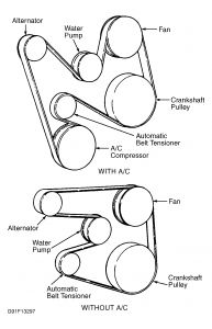

How to remove drive belt and auto belt tensioner is leaking fluid, should it be replacedl
Jan 20, 2009 at 9:12 AM
BMRFIXIT
  • 19,053 POSTS
check the link provided below
as far as the tensioner leaking
I doubt its the tensioner
check the diagram again
https://www.2carpros.com/car_repair_information/tec_info/2001/dodge/ram_wagon/2001_dodge_ram%20wagon_drive_belt_routing_diagram.htm
let us know

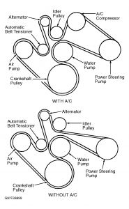

DAVE H
  • 13,384 POSTS
Where do you have a leak from ?? Locate accessory drive belt tensioner, and rotate tensioner clockwise (counterclockwise on heavy-duty cycle engines) to release tension on accessory drive belt. Note drive belt routing for installation reference. Belt must be correctly routed during installation, or engine will overheat due to water pump rotating in wrong direction.
https://images.2carpros.com/forum/automotive_pictures/266999_59_1.jpg
https://images.2carpros.com/forum/automotive_pictures/266999_591_1.jpg
