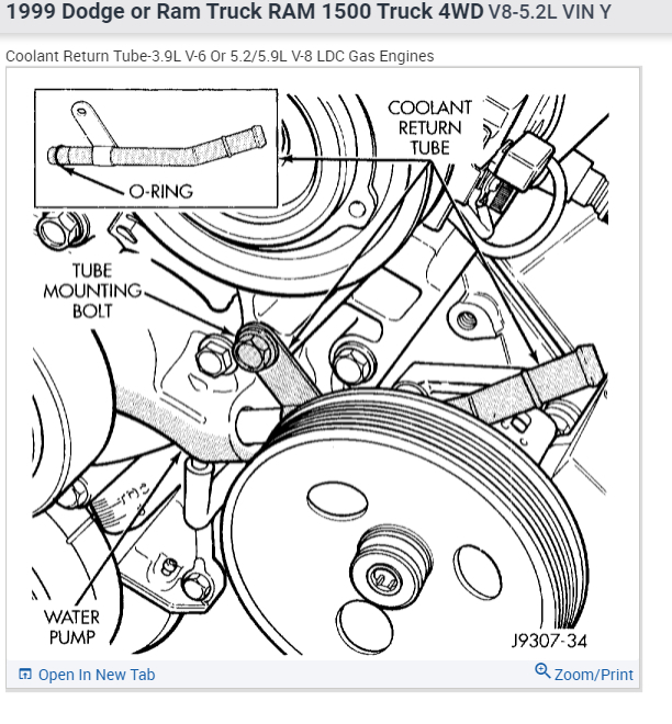

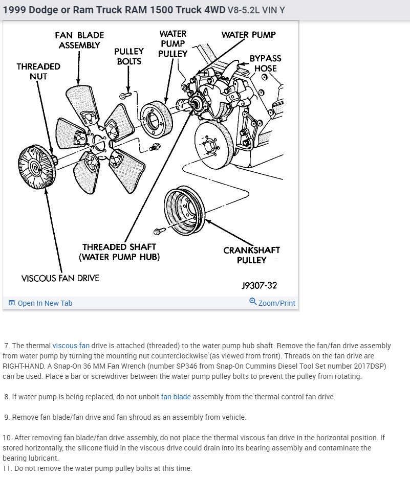

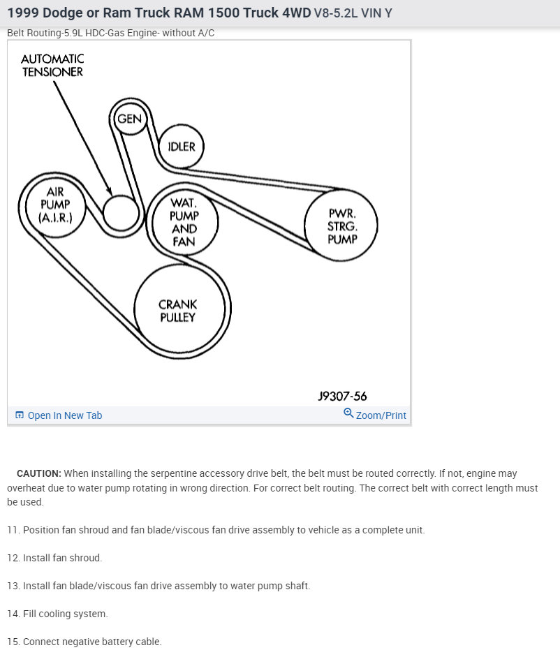

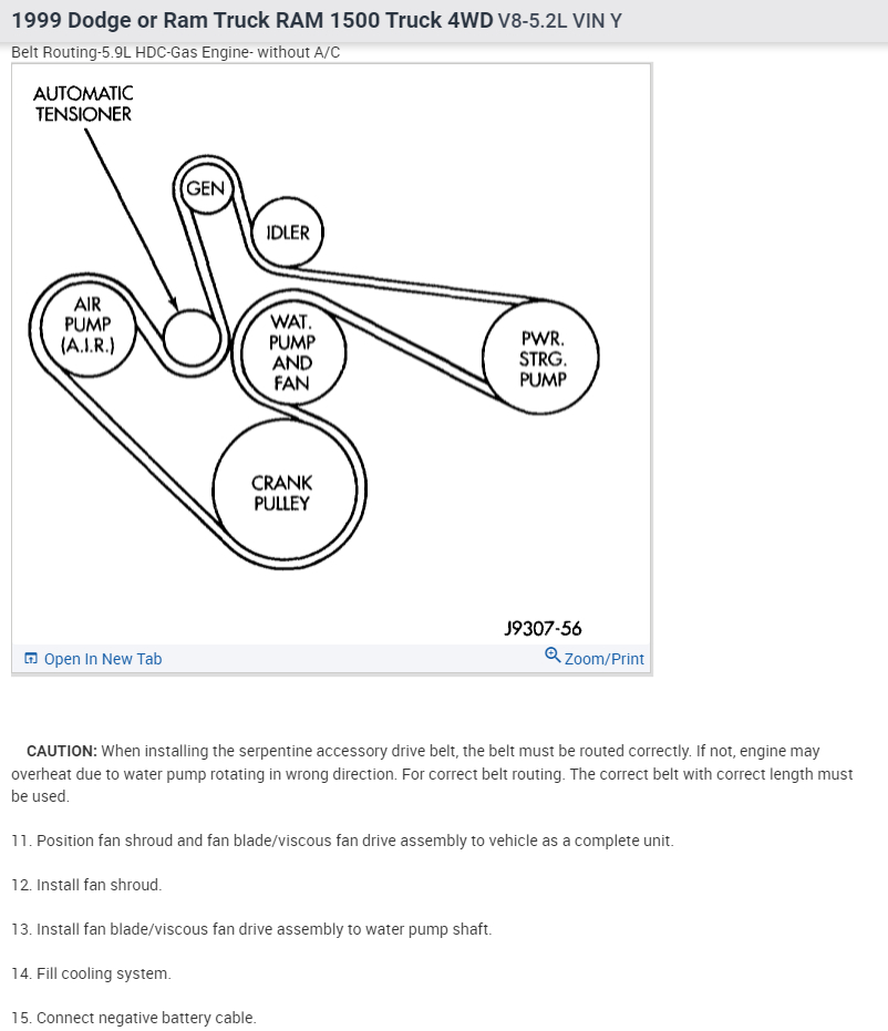

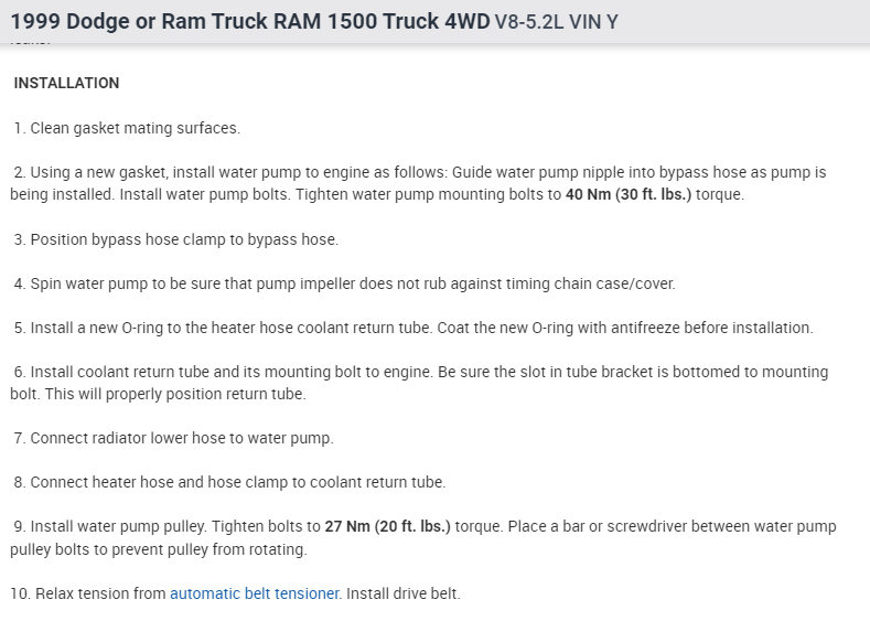

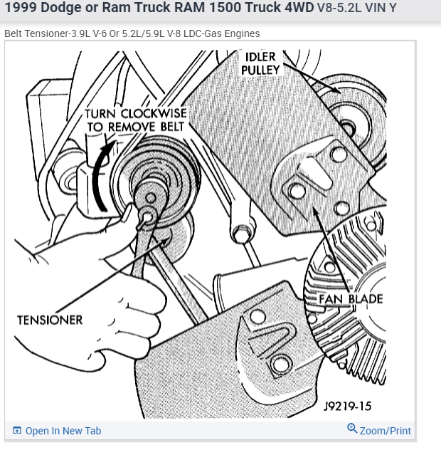

Engine began making noise as if serpentine belt was bad. Changed belt but noise continued. Coolant began to pour out at a rapid pace. Seemed as though the water pump gasket was bad. Changed gasket but coolant leak continues at same level amounts. Can the water pump be leaking behind pulley where it's not visible?

Yes impeller seal has failed coolant leaking out bottom of pump through weap hole. Time for a new pump

Could also be the timing chain cover leaking. They are bad to leak. The water pump sits on top of the timing chain cover. If you grab the fan and try to wiggle it and it has play (fore and aft), it is the water pump. If not, it may be the timing chain cover. Most likely the water pump, but I'd look at the timing chain cover first to make sure it's not coming from there.

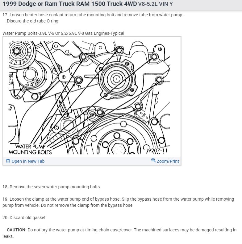

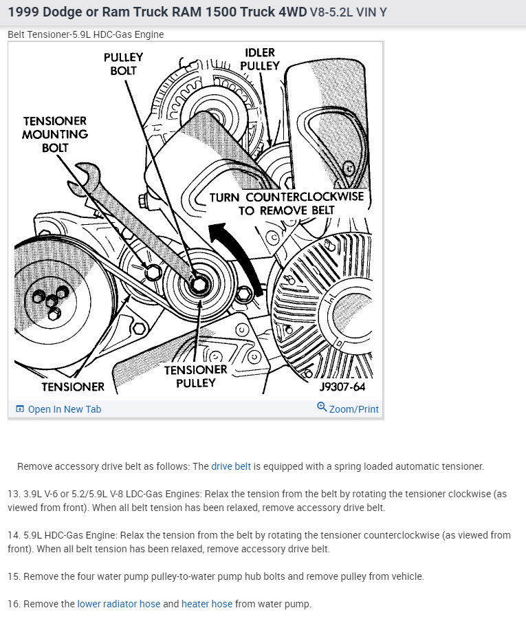

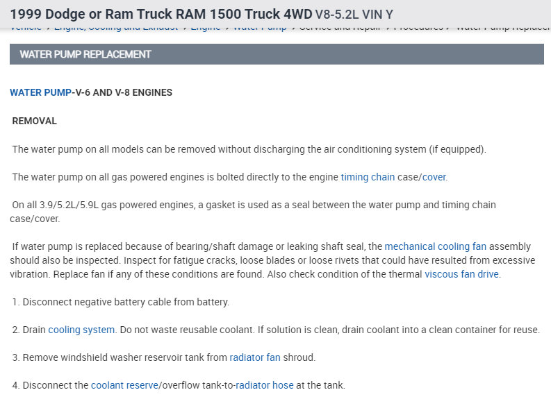

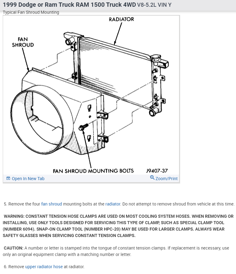

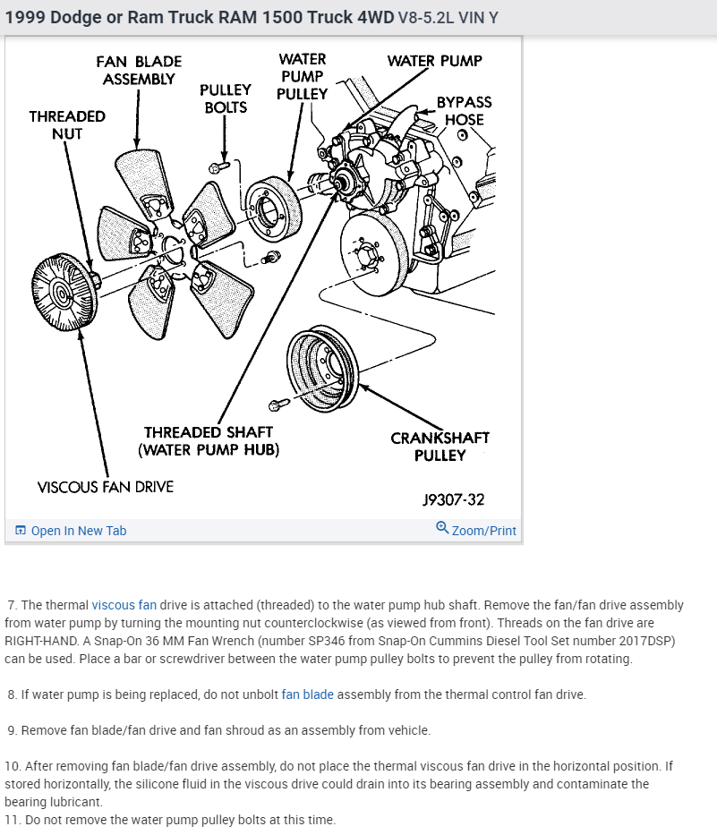

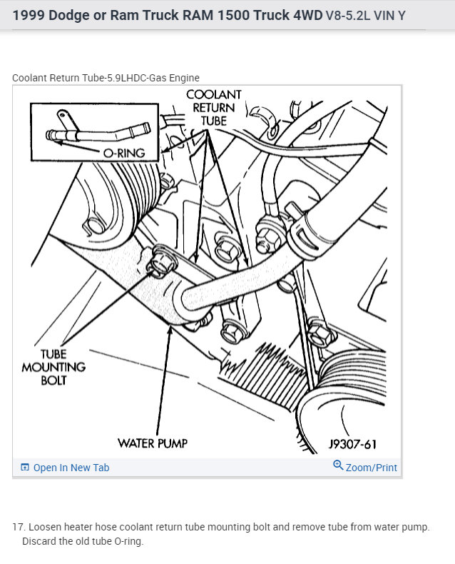

The leak is likely from the water pump weep hole due to a failed impeller seal. Which will require the water pump to be replaced to fix the leak.
Here is a helpful guide:
https://www.2carpros.com/articles/water-pump-replacement
