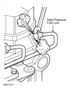

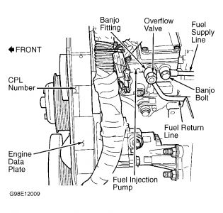

I have a 2000 Dodge Ram diesel that quit running abruptly after hitting a very bad bump. Is there a rollover fuel pump/ engine shutoff switch on this truck like cars have? If so, where is the reset for it? I don't want to change the injection pump and find out I have a minor electrical problem. We have checked everything else, but can't find any reference to a rollover shut off like most cars have. Thanks for your assistance.

I have fuel pressure and plenty of fuel coming up to the injector pump, no pressure after the pump, tried to bleed system, no fuel at injector lines.
I have checked the fuel pump relay and the ASD relay and they both are working properly.

Try bleeding low pressure side first at banjo fitting
https://images.2carpros.com/forum/automotive_pictures/198357_Graphic_125.jpg
Then open injector 3-4-5 bleed

I bled the low pressure side thru the banjo fitting while cranking the engine. Got some air out. Afterwards, still no fuel at the injectors.
