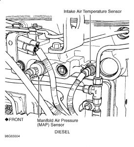

im trying to find the iat sensor on my dads diesel pickup i have bought a performance up grade chip that requires the location of the iat sensor to piggy back the iat sensor.

the intake air temp. (IAT) sensor for the diesel motor is located in the left rear side of the intake manifold, pic below..
https://images.2carpros.com/forum/automotive_pictures/261618_Graphic_256.jpg
