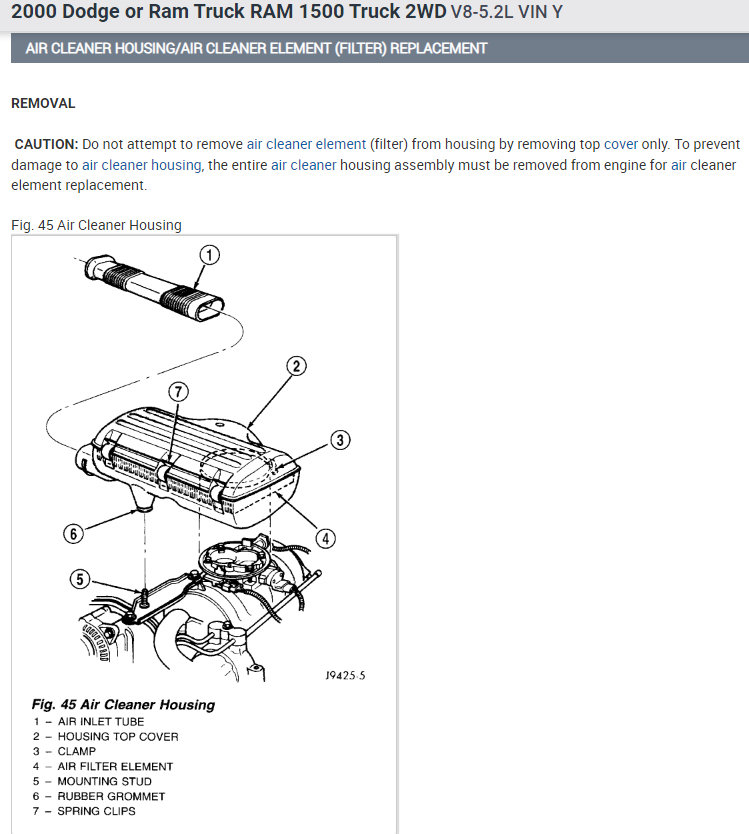

how do i open the air filter housing?
Feb 13, 2009 at 11:56 AM
SQM
  • 6,383 POSTS
In order to replace the air filter, you will have to remove the entire air filter box out of the vehicle.
It can be done quite easily in a short period of time.
https://www.2carpros.com/articles/how-to-replace-a-car-air-filter
See the instructions below on how to change the air filter on your Ram.
