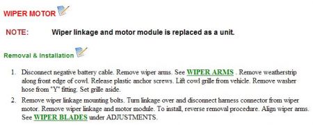

Have been told I need to replace my windsheld wiper motor assy. Can anyone direct me to a good step by step procedure. Cannot affort to pay the dealer the $600+ to do the work.

https://images.2carpros.com/forum/automotive_pictures/261618_Noname_1647.jpg

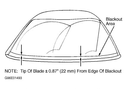

https://images.2carpros.com/forum/automotive_pictures/261618_Noname2_511.jpg
