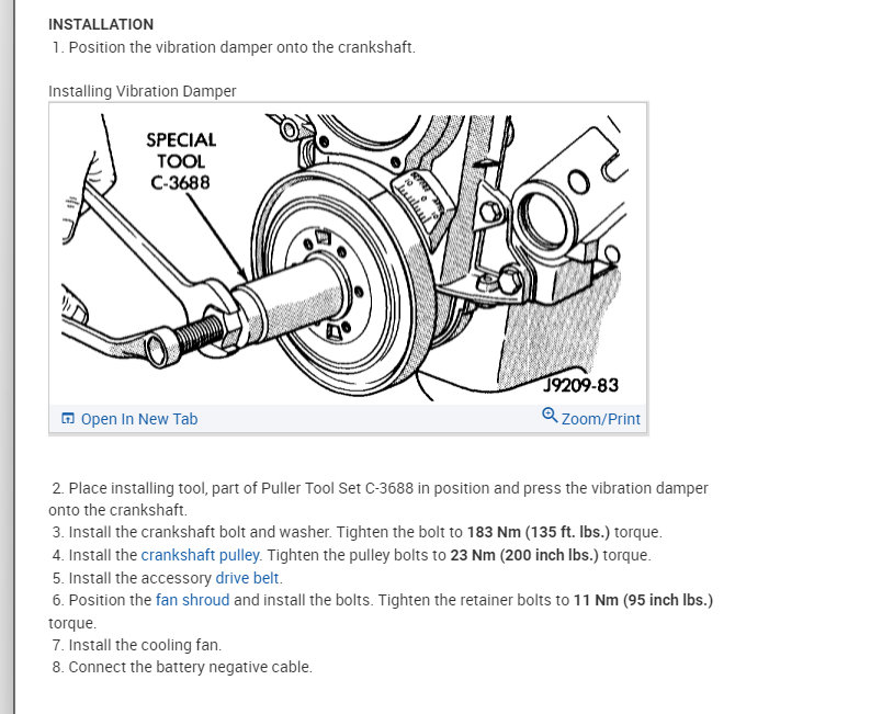

When vehicle is running you can see the belt not sitting correctly on the far bottom pully. When vehicle is of it sits correctly.
Friday, September 25th, 2009 AT 2:47 PM

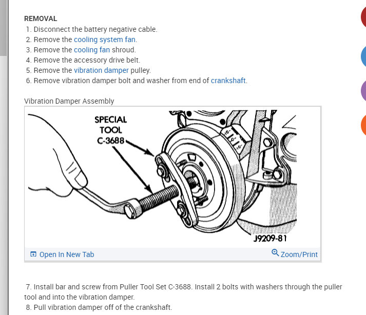

More than likely your balancer is the issue. This is the pulley that is connected to the crank shaft.
Here are some guides that will with this:
https://www.2carpros.com/articles/how-a-harmonic-balancer-works
I am attaching the info below to help replace this which is what needs to happen before this breaks or it can damage the engine and then you have a much larger repair.
Please run through this info and let us know what you find. Thanks
