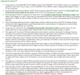

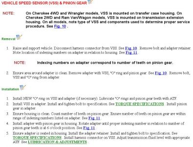

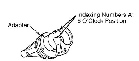

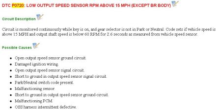

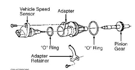

Hello
I need to change the shaft speed sensor for 1999 dodge ram, It won't shift, the code came up P0720.
I can't find it!!!
Thanks
George
Apr 13, 2008 at 1:32 PM
SERVICE WRITER
  • 9,123 POSTS
Do you want the diagnostic procedure first?
https://images.2carpros.com/forum/automotive_pictures/30961_po720a_1.jpg
https://images.2carpros.com/forum/automotive_pictures/30961_po720b_1.jpg
More coming. Check your email shortly for larger images. It is on the overdrive transmission case.
