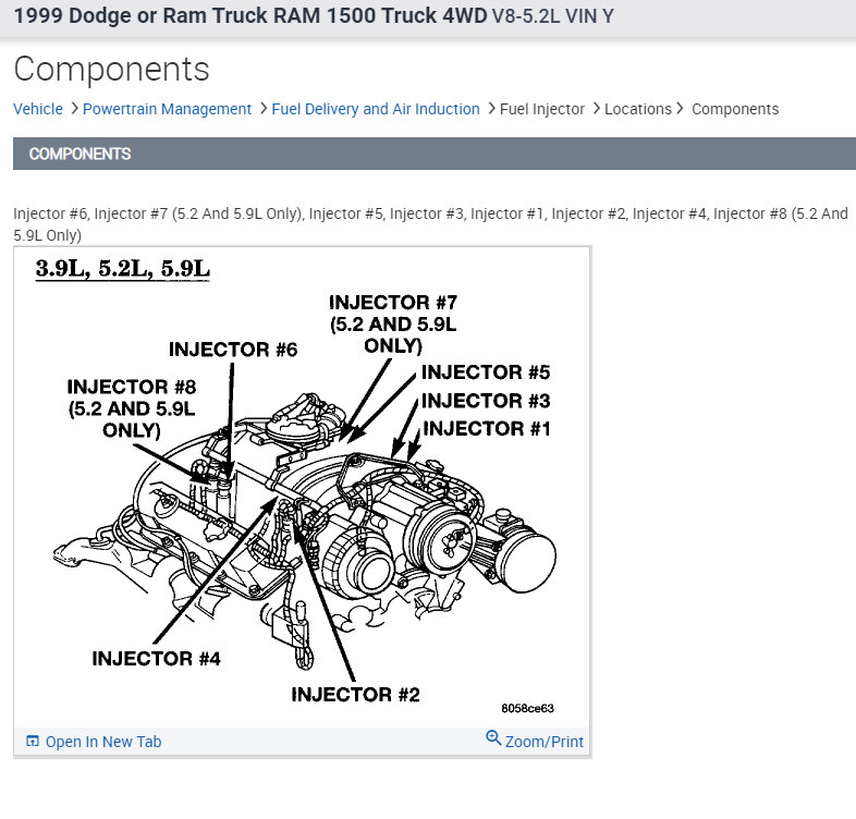

i was driving down the road and my truck started to loose power at larger throttle openings and then just died like it ran out of gas. it will not start again and tries to fire at wide open throttle. i have spark. i checked timing and it is good. i have 46 psi fuel pressure at the rail when i turn the key on. the motor only has 160 000 km. the motor has good compression. it has newer plugs.

If you have spark, fuel, the timing is good, and there is good compression, it should run. Was it running good up until this happened? Also, have you checked for an injector pulse?

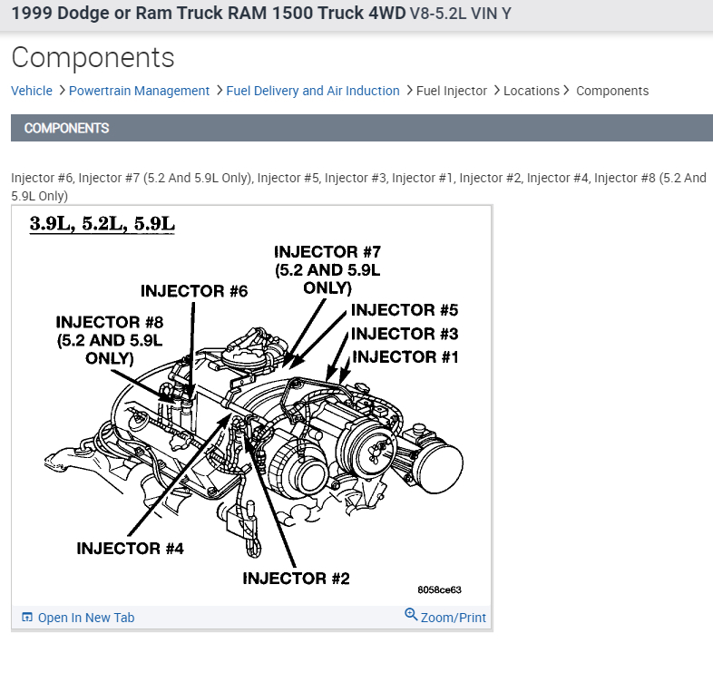

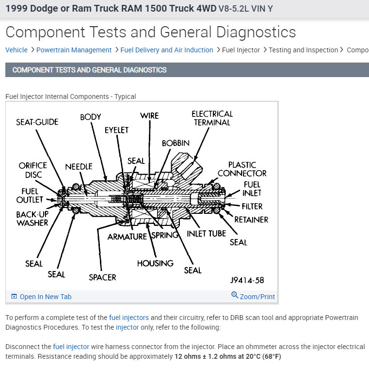

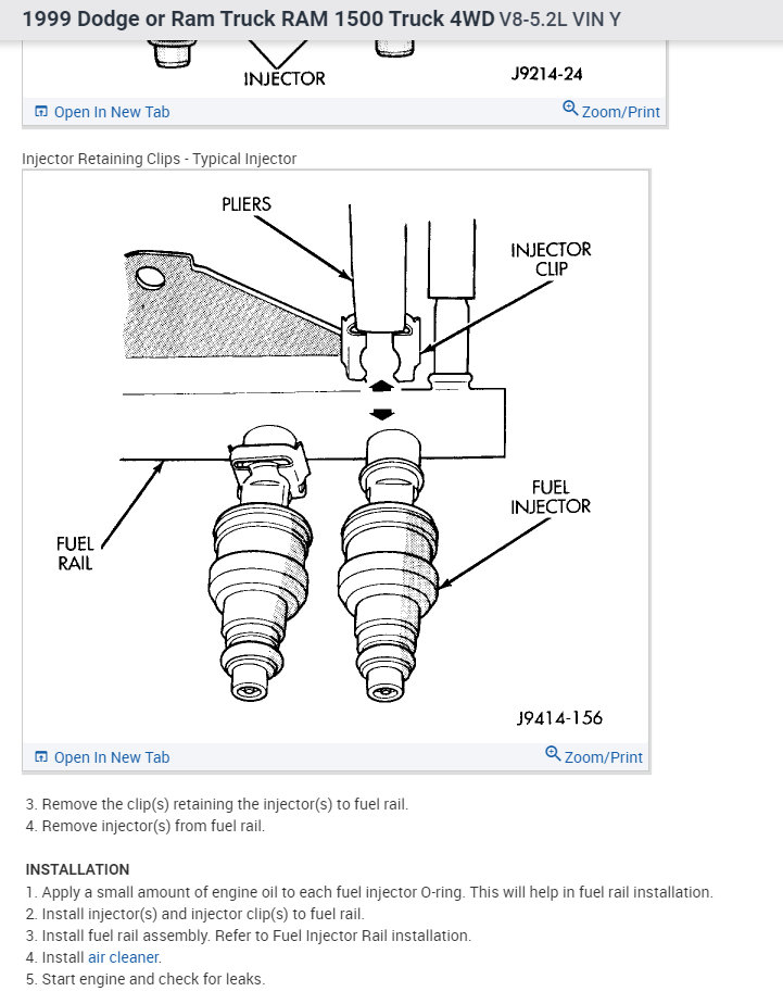

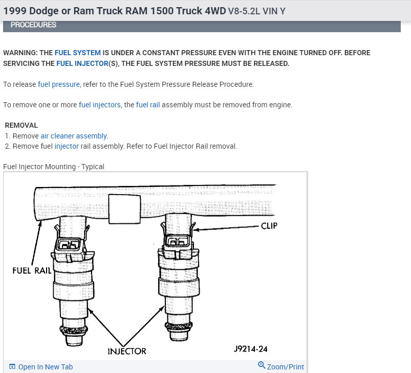

You can check the injector pulse using a test light and multimeter.
Take a look at this guide, it covers how to test fuel injectors:
https://www.2carpros.com/articles/how-to-test-a-fuel-injector
I have attached the injectors diagrams below for your reference.
