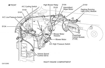

is this a relay problem or what? motor only runs on high

relay is good
blower motor speed resister no good
replace it
let me know

Inbox :: Message From: greg21158 To: BMRFIXIT Posted: Sun Jan 20, 2008 3:59 am Subject: heater blower mototr Is the resister located next to the blower motor on the 99 dodge ram? and do you know if you can buy these at like auto zone or do you have to get them through a dealer? Thanks for all your help i alway used the dealer for this part its located beside the blower motor check this let me know
https://images.2carpros.com/forum/automotive_pictures/99387_ram_resister_1.jpg
