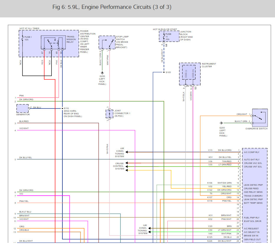

V8 two wheel drive automatic 167000 miles.
I recently have had random shutdowns while driving my truck. Driving along at fifty five mph and all the sudden a loss of power. Pull over to the side. I turned key off then on again and it started.
A few blocks down the road it did it again very quickly though. It lost power (like not getting fuel) slowed down and then it came back and I continued on to the gas station. I thought fuel problem (3/4 of tank of gas) so I got some STP gas treatment at the station.
No problems for a couple of days and then all of the sudden it did it again. This time it would not come back on. I was thinking fuel pump. But I noticed something strange. When I would turn the key to the "on" position all the gauges (gas gauge/oil gauge/battery gauge) would move a little but go back to the flat position. This made me think it was some sort of electrical or relay problem. I opened the hood and found the relay box and just gently tapped on the top of the relays etc.
I got back in the car and when I turned the key to the "on" position all my gauges were working (coincidence? ). The truck started and worked fine.
Is there something other than a relay that can cause this kind of symptom. If the relay is bad would it cause the fuel gauge to not respond?

It happened again today July 13th. This time it provided me with another clue. I notice where the odometer readout is, the words "no bus".
I opened the hood and messed with relays and nothing happened. I turned key off then on again and odometer was normal but fuel gauge did not read anything. I plugged in my code reader and waited and then the odometer read "no bus" again.
I figure that it is the PCM or the connections to it. So I took my screwdriver and lightly tapped a small black box that is located behind the Relay box (Is that the PCM?)
I got in and turned the key to on and the fuel gauge went up. Truck started.
Is there something I can do to check the connections and rule out that the PCM (computer) is bad?
Anything else I should check given this new clue?

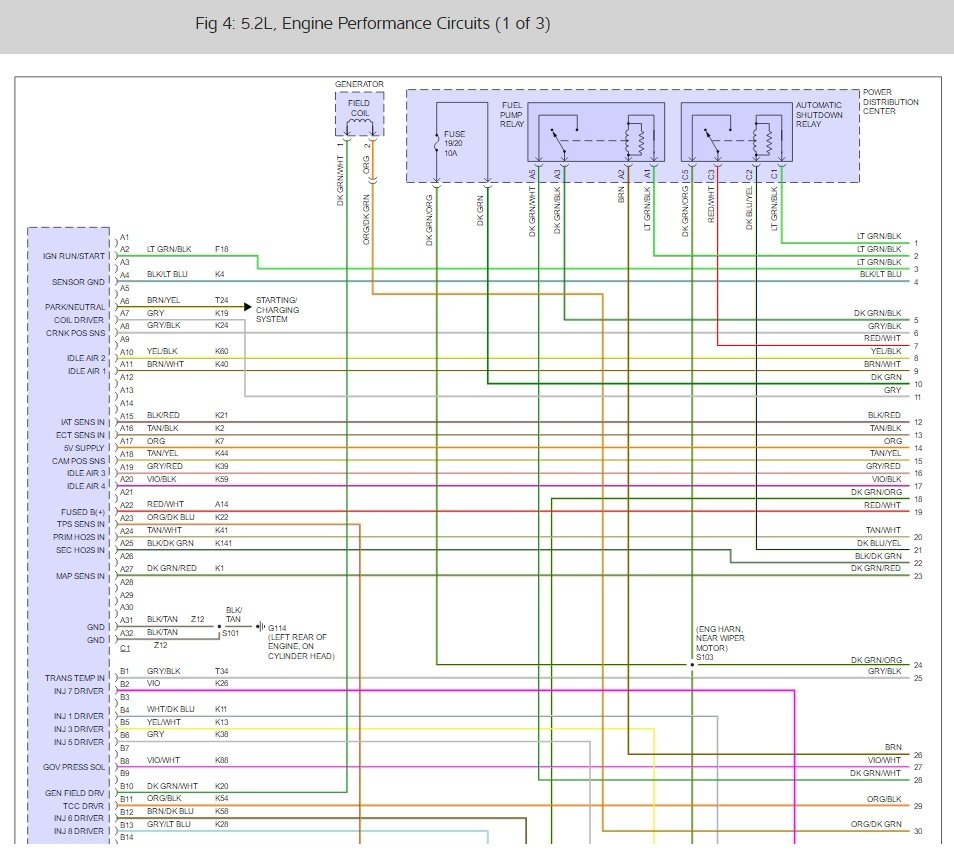

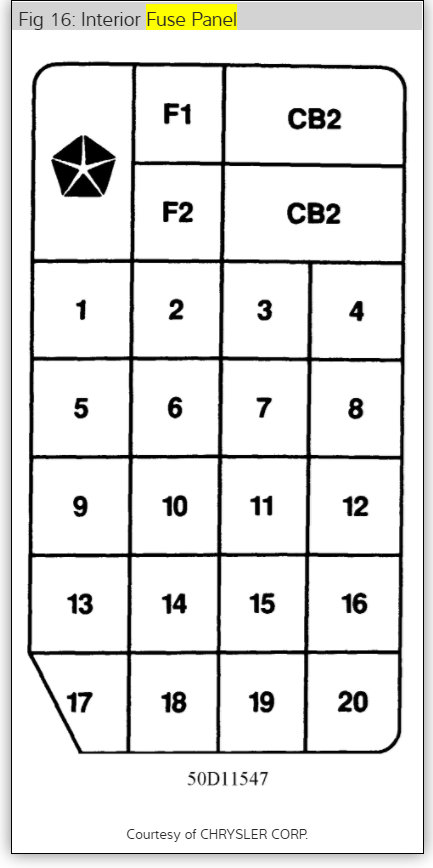

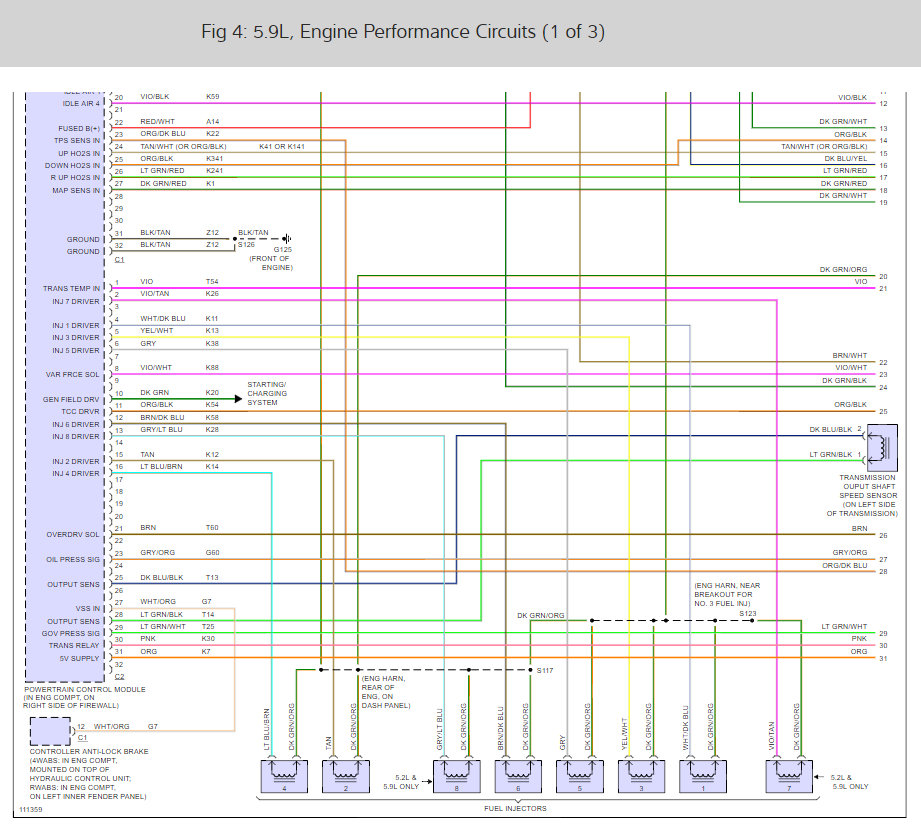

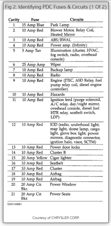

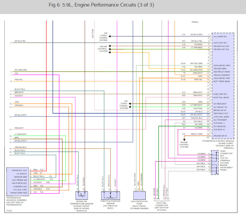

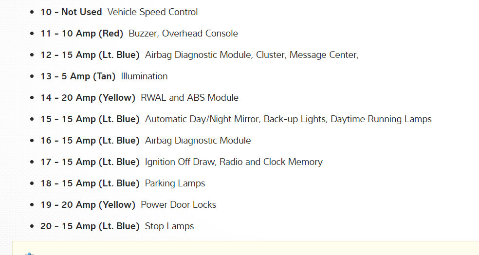

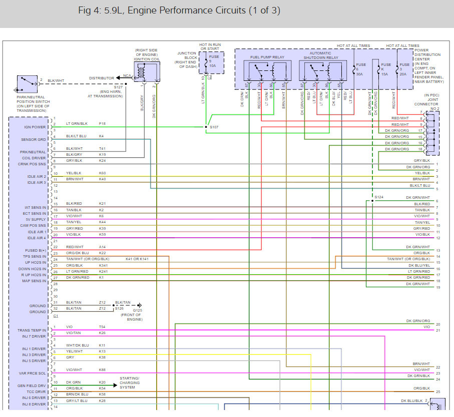

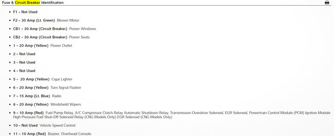

It sounds like you have a fuse out somewhere in the truck. Here is a guide and some wiring and fuse panel diagrams so you can do some easy testing to find the problem.
and
That is a good clue. The no bus indicates there is no communication between the PCM and its components. Just remove the wiring harness to it and check for corrosion and make sure everything is tight.
Let me know what you find.
PS: I believe what you described is the PCM and usually they are either good or bad, so my guess is a bad connection or broken wire.
Below is fuel pump and engine wiring diagrams along with fse panel information.
Cheers!

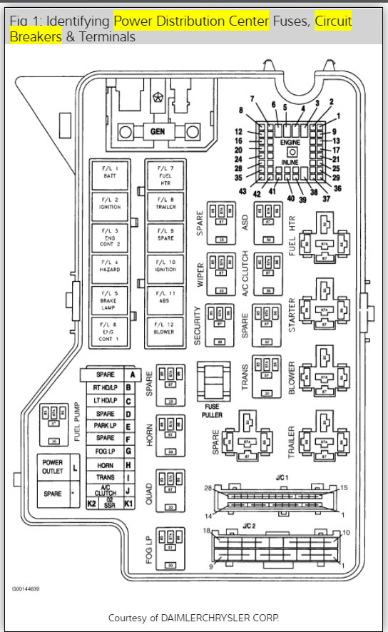

Found the problem! It was the "engine inline" plug that plugs into the black fuse box under the hood that houses the relays etc. See picture (top left hand corner of box). I unscrewed the screw (noticed it was a little loose). cleaned contacts on the pins with contact cleaner and then applied dialectric grease to the contacts; screwed it back in place and it has been running like a top ever since. This is one for the books!!! Thanks for all the help. This is a great site!

Great job. That is what was causing the no bus signal. Thanks for using 2carpros.com, and let us know if you have questions in the future.

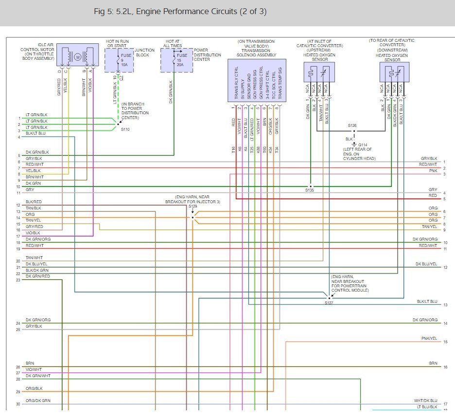

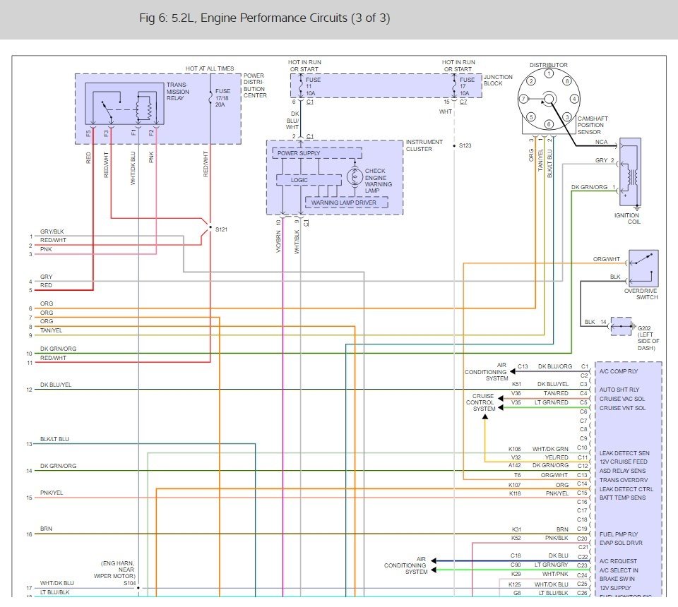

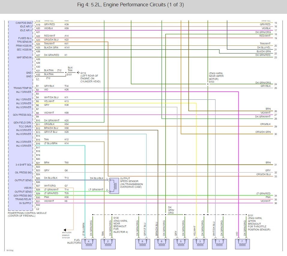

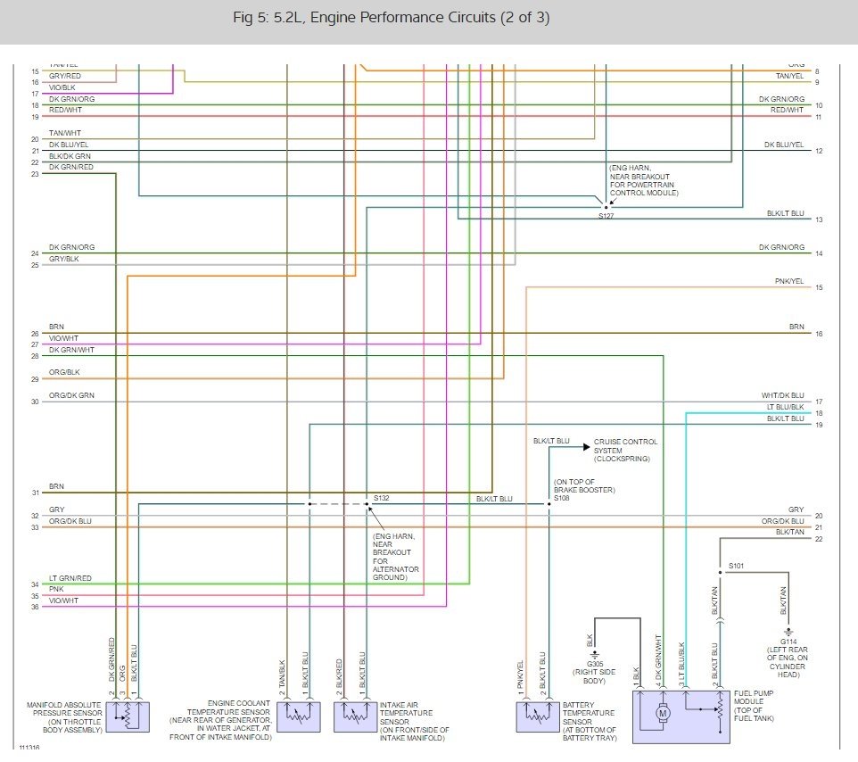

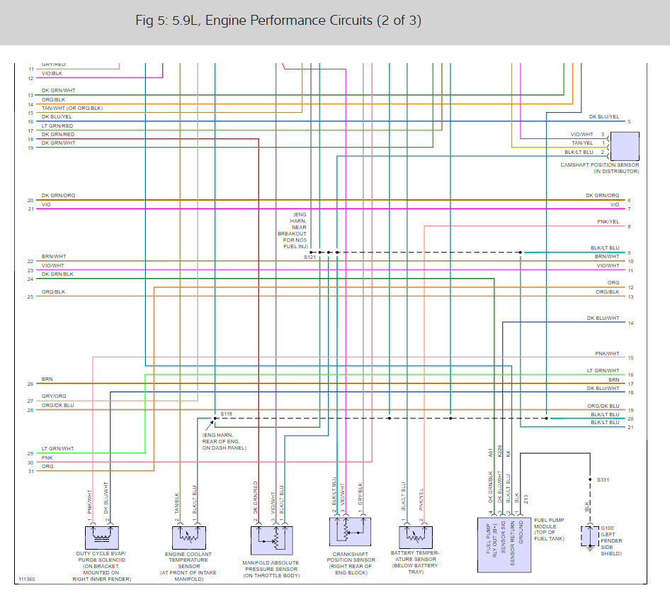

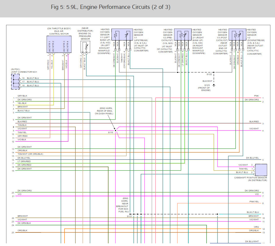

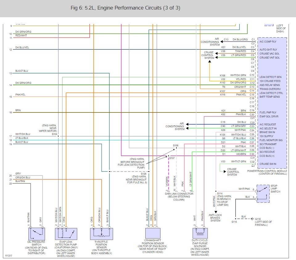

I found the fuel pump and engine wiring diagrams for you (below) just in case someone needs it.

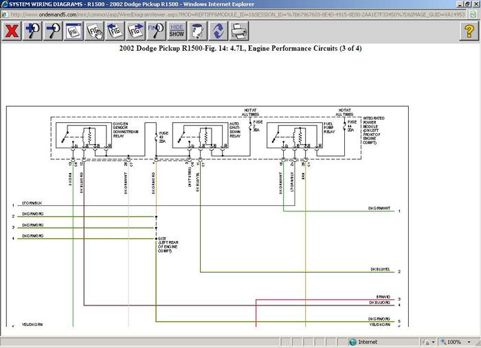

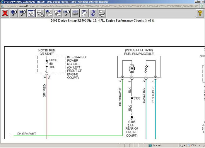

Im trying to replace the fuel pump in my truck but am not sure about the wiring, can you send me a colored diagram. Basically Im trying to find out which is the wire that goes to the power
Nov 22, 2017 at 2:30 AM (Merged)
SATURNTECH9
  • 30,869 POSTS
If its a ram van which model also what size engine?
MRSSALAS08
  • 8 POSTS
It is a 2002 Dodge Ram 1500 Truck with a 4.7 engine, like I marked on the section before the question
SATURNTECH9
  • 30,869 POSTS
There you go also as you can see the model and engine size doesnt show up on the question you asked.Atleast not that iam able to read and see thats why i asked.
