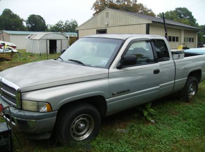

my dodgeram i s not GETTING FIRE I CHANG THE CRANKSHAFT SENSER BUT STILL NO FIRE I DONT HEAR THE FUEL PUMP NOISE TELL ME WATS STOPPING THE CARR FROM GETTING FUEL TO START THE CAR[img:5fafa10b13]http://www.2carpros.com/forum/automotive_pictures/426601_djones_truck_010_1.jpg[/img:5fafa10b13]

Check fuse no. 6 and 9 in the power distribution center
Test,Swap or replace the ASD relay it powers the coil/s and injectors and also test the fuel pump relay

where is fuse 6 and 9 in the distrubuter center

nothing comes on im not getting power nowhere i check fuse battery thats fine it do nothing

No power anywhere check and test all the fusible links

whats fusible links

i check all fuses and still no gas getting to the front of the truck what should i check next i put a new fuel pump
