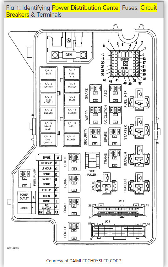

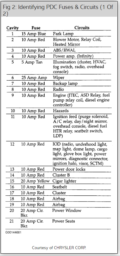

Fan blower motor will not come on at any speed. Disconnected plug at fan motor and hot wired motor, it worked.changed fuses and relays at fuse box and under hood. Took blower fan switch out of dash and checked back of plug, with key on, with test light. There seems to be no current flow at the switch, which I checked with test light also.
Jul 4, 2009 at 10:45 AM
BUDDYCRAIGG
  • 2,262 POSTS
This sounds like the blower relay is not working. Here are the wiring diagrams and guide to help check the relay with the relay location:

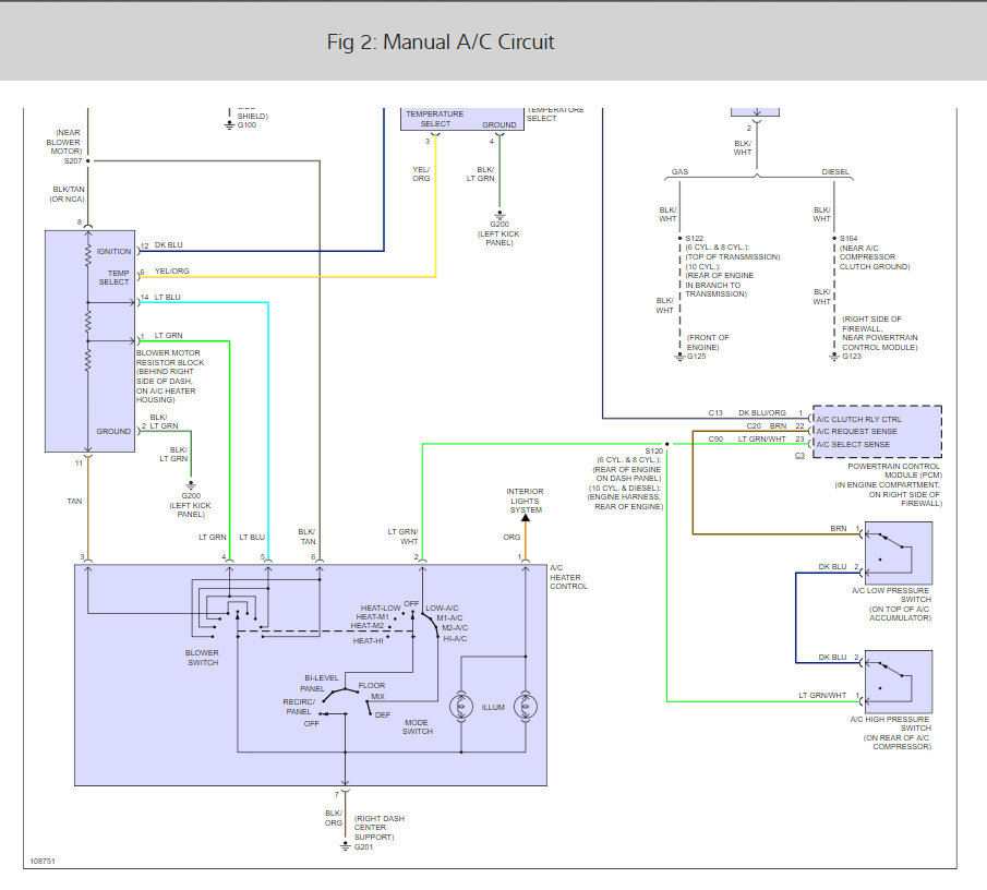

Thank you for the response. I do not quite understand about Dodge electrical working backwards (may need to explain a little better). Any more information would be greatly appreciated.
Apr 23, 2021 at 3:42 AM
BUDDYCRAIGG
  • 2,262 POSTS
For most cars, the power flows this way.
Battery>ignition switch>fuse box>heater control head>blower motor resistors or relay>blower motor> ground. Most dodges are backwards. Do you have a Ram van or truck?

The blower speed switch and the lights that illuminate the heater controls share a common ground.
You have a bad ground with that circuit.
So when your lights are off, your blower is finding a ground, "backwards" through all of your lights.
When you turn the dash lights on, the ground goes away.

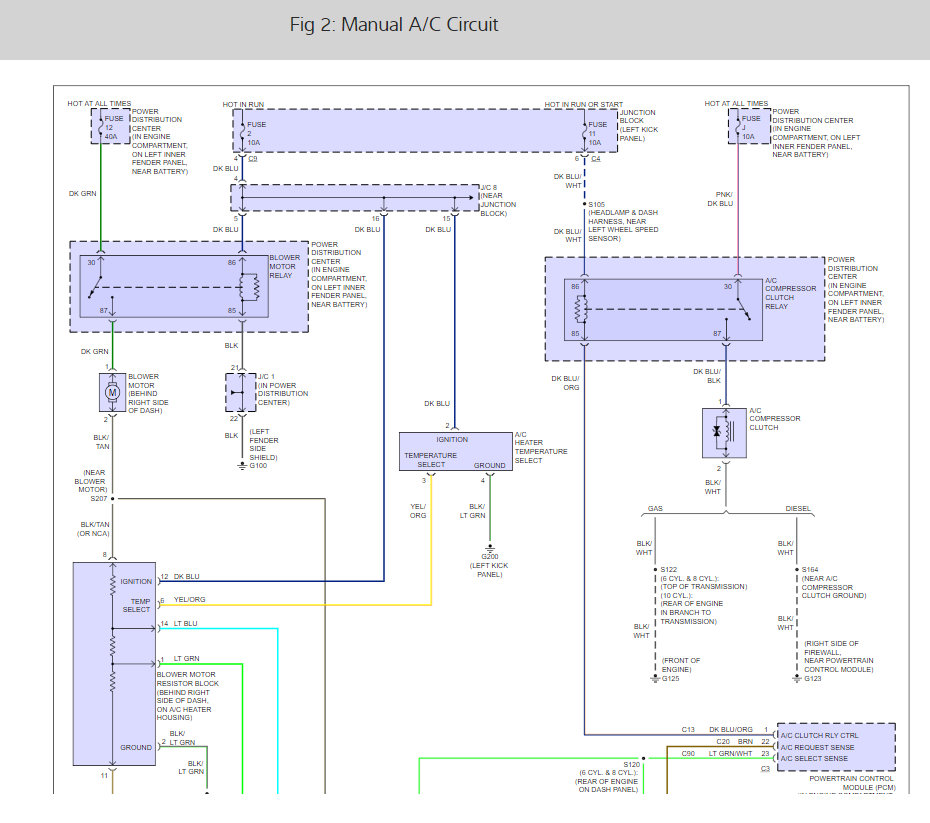

I saw there was a recall (today) to add a relay off of the parking brake and I have seen it there, but I have not checked it (tonight maybe).
I' have replaced the blower motor resistor (it was a little off but probably not bad) and checked the voltage (Hayne's says green but mine is coming in on the orange wire to the motor) to the motor and it is fine, but the ground is not getting connected to the motor. (less than 0.5 volts read between the positive and negative on the wires to the motor, but full 13+ volts when I use a door hinge bolt as ground). The backwards wiring makes a lot of sense.
I have checked the control switch pin continuity and they vary with the setting, so that seems fine (but no wiring info on what the pins on the control do). I have full voltage between the bottom wire and some of the others. The vacuum lines are good, no leaks, surprisingly.
Where is the ground connection that the blower motor circuit would use? I applied CAIG DeOxit D5 (amazing stuff) to the ground connections I could find under the hood and cleaned up most connections if they looked rusty/oxidized but I feel like there is a broken ground connection. Because it stopped working intermittently and then later stopped completely, I feel like it is a connection somewhere.
Any tips would be appreciated.

It sounds like you are on the right track and will probably figure out where the problem is once you see the schematics.
Remember there are two switches in the heater control head that the ground goes through, the speed switch, and the mode switch.
JALEX19100
Thanks for the schematic. It was the relay, apparently. The relay is working but was not connecting somehow. I sprayed the connection with the Deoxit D5 and connected/reconnected it a few times and it has been working normally again. No more scraping the inside windows now!
