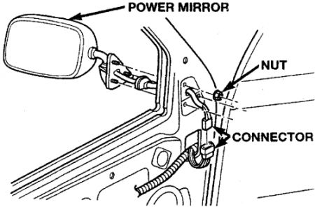

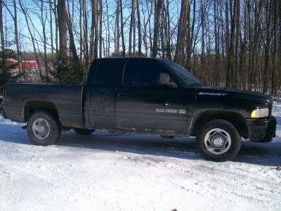

How do you remove a 1999 Dodge Ram 2500 driver's side mirror? I am looking to replace it and can't figure out how to get it off.. [img:905efa7d35]http://www.2carpros.com/forum/automotive_pictures/312827_dodge_1.jpg[/img:905efa7d35]
Feb 4, 2009 at 12:52 PM
BLUELIGHTNIN6
  • 16,542 POSTS
Remove the door trim panel. Remove the mirror flag door seal. Disengage the wiring, if so equipped. Remove the nuts attaching the mirror to the door frame. Separate the harness grommet from the door frame, if so equipped. Remove the mirror. Installation is the reverse of removal. (((Typical power mirror wiring connector)))

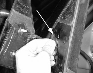

(((Removing the mirror flag door seal)))
https://images.2carpros.com/forum/automotive_pictures/261618_0900c152800c0e99_2.jpg

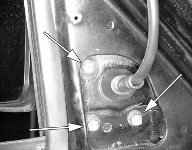

(((Removing the three nuts to remove the mirror)))
https://images.2carpros.com/forum/automotive_pictures/261618_0900c152800c0e99_3.jpg

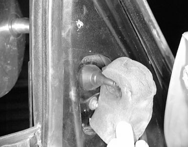

(((Separating the wiring harness grommet)))
https://images.2carpros.com/forum/automotive_pictures/261618_0900c152800c0e99_4.jpg
