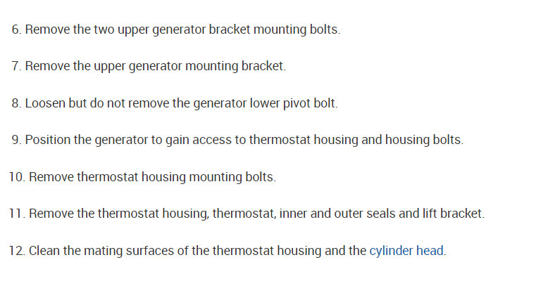

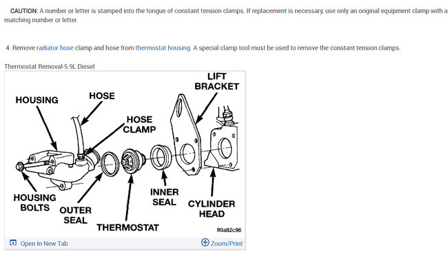

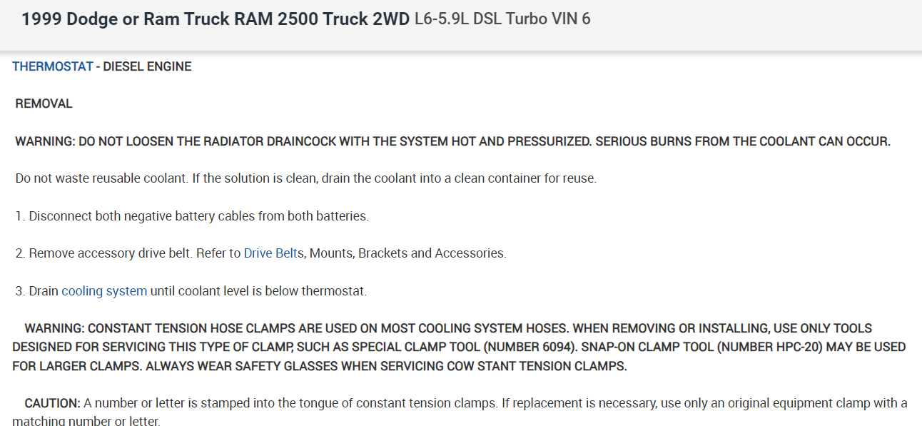

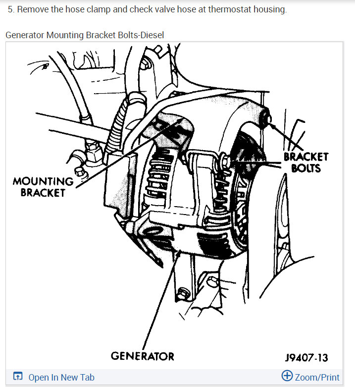

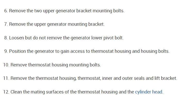

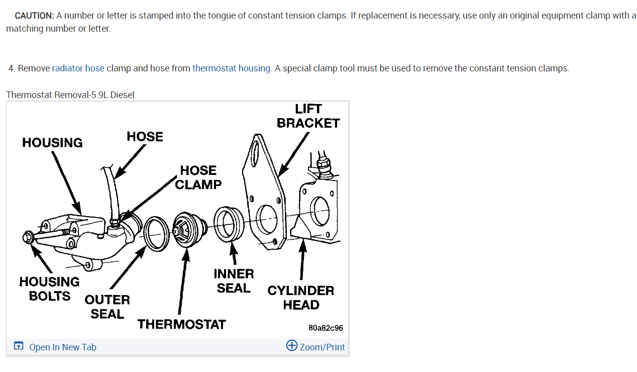

Nice work, yes the #1 reason an engine will not heat up is the thermostat. Here is the correct way to replace it in case you need it. Check out the images (below). Let us know if you need anything else.
