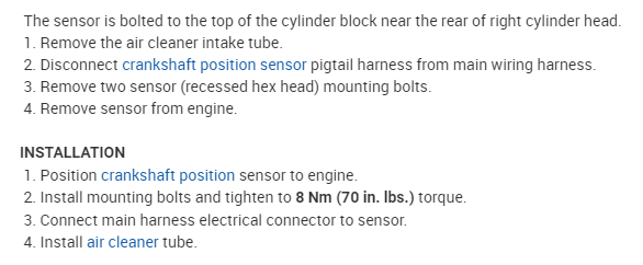

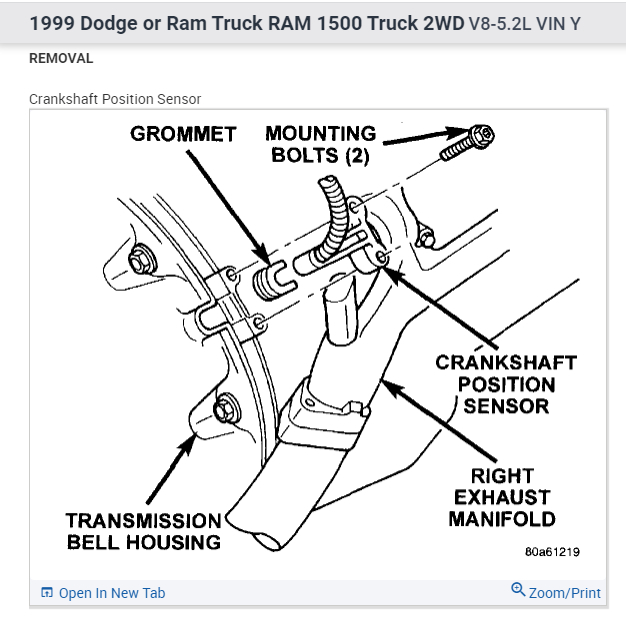

I have a dodge ram and when the motor gets hot it stalls out. Then I have to let it sit for about an hour before it starts back up
Monday, February 18th, 2008 AT 9:45 PM
  • 109,917 POSTS
Based on your description, I suspect the crankshaft position sensor is failing. What happens is this. When the sensor starts to fail, it is adversely affected by heat. This can cause the engine to lose ignition spark and stall. Then, you need to wait until it has a chance to cool before it will restart.
Take a look through this link. It explains the most common symptoms of a faulty crankshaft position sensor. Read through it to determine if it mirrors what you experience.
If you determine it needs to be replaced, here is a link to get you started. It explains in general how one is replaced.
If you look below, I included the directions specific to your vehicle for replacement.
