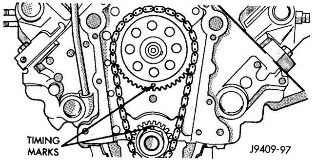

If I don't have to put my engine at top dead center when replacing the timing cover gasket...how do I make sure the bottom crankshaft pulley doesn't move when I remove the vibration damper when I pull the timing cover off?
Jan 6, 2020 at 2:07 AM (Merged)
JIS001
  • 3,412 POSTS
You should set it on time in case it does move. That way you have a reference point to set it back.
STEVE W.
  • 15,423 POSTS
To add to that, both the dampener and the timing gear are keyed to the crankshaft on that engine. They really cannot be put on in a different position. That is why they don't tell you to set it to TDC. Now that said, I like to break the crank bolt loose, then set the dampener to TDC if it has a timing tab and marks. That way you can look at the timing chain while you have to cover off. Be sure to change the crank seal and look at the dampener for wear in the area the seal rides. With the miles you list I'd probably put a timing chain and sprockets on it as well, as you will already have it apart.
