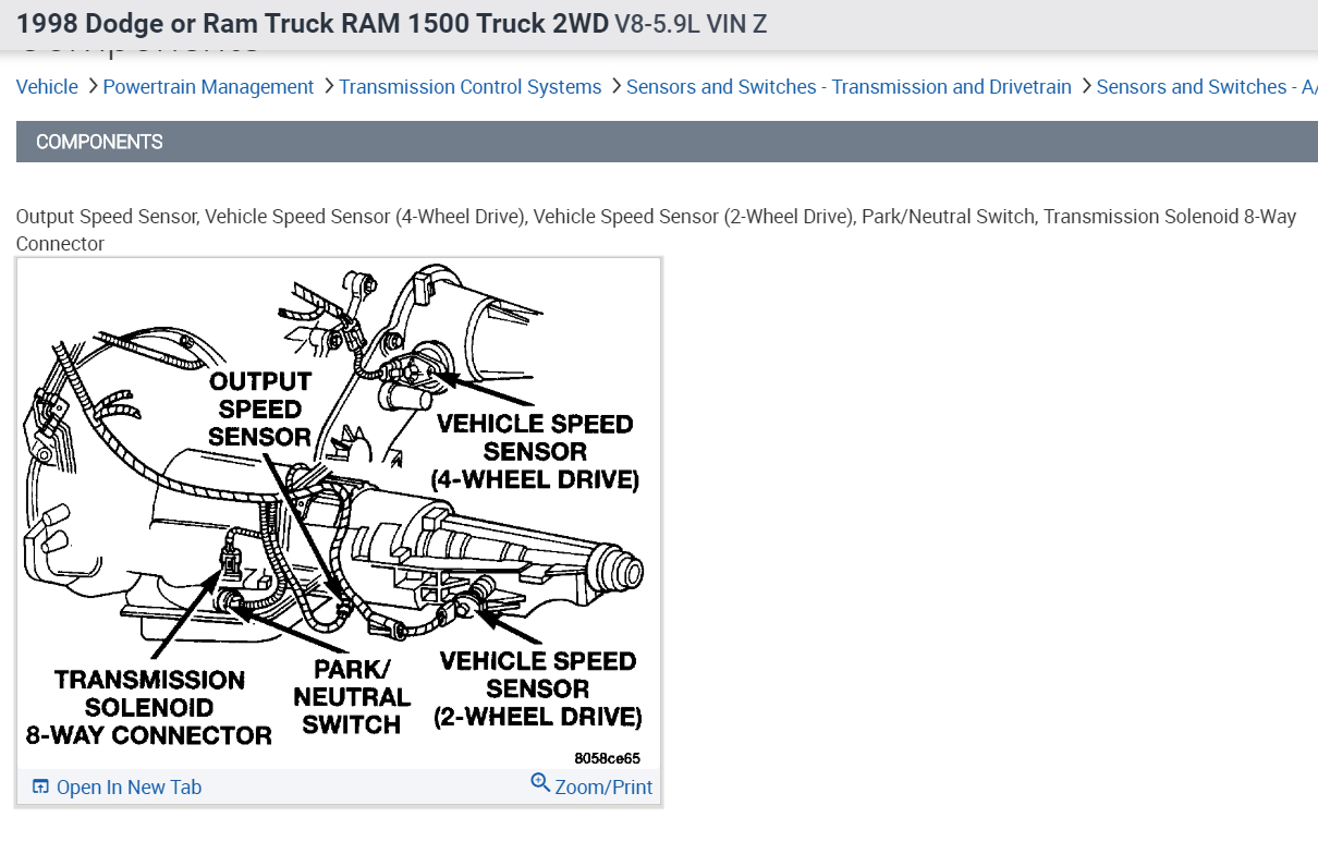

Where is the output speed sensor? How do I change it?
1998 DODGE RAM
133,000 MILES • V8 • 2WD • AUTOMATIC
KLOWERY21
Where is the output speed sensor? How do i change it?
Jul 27, 2008 at 11:03 AM
BMRFIXIT
  • 19,053 POSTS
The output or vehicle speed sensor is in the rear of the transmission. On a 4x4 it is in the transfer case Check out the diagrams (Below). Please let us know if you need anything else to get the problem fixed.
