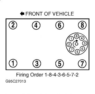

How will i know if i got the 1 and 3 spak plug cable on the right spak plug
Aug 27, 2009 at 7:18 PM
BLUELIGHTNIN6
  • 16,542 POSTS
because the engine will have a slight miss in it and will lack power. the firing order is below for the 5.2L engine..(if your engine size is different, let me know and I will post correct firing order) ..

its the 5.9 and i got the the 1 and 3 maybe mix up with each other
Aug 27, 2009 at 7:34 PM
BLUELIGHTNIN6
  • 16,542 POSTS
this is 5.9L firing order
