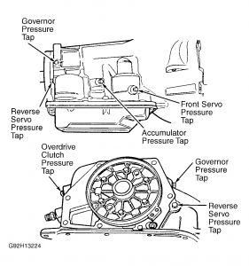

Scan tool needed is like the one I use a Snap on MODIS and costs $9700.00. As for pressures check Drive /overdrive see figure to ID tap.
https://images.2carpros.com/forum/automotive_pictures/198357_Graphic_660.jpg
Remove overdrive clutch tap install 300psi gague. Have vehicle wheels off ground trans in drive increase engine speed untill 3-4 shift NOTE pressure 68-72 psi at closed throttle and 90-120 at 1/2 to 3/4 throttle MAX 130psi. If pressures not reached the internal fluid loss

I did a pressure test on the overdrive clutch tap, and when in drive, the pressure was around 50psi at closed throttle and at 85psi at ½ throttle, and pressure readings where the same going down the road. Do you think fluid is getting by a seal somewhere in the transmission?

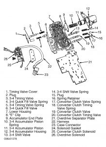

With pan off check for clutch material, silver metal shavings. Also pull off TCC solenoid see if sealing ring is good and plug on shift valve is in and tight. Sending diagram but it is transfering small try and move to like a Microsoft works see if you can enlarge

There is a little metalic sludge on the magnet in the pan, I see this on a lot of transmissions and seems normal. Solenoids look fine and operate with 12v applied. checked connections and wire harness and there are no opens. It could be the valve body or torque converter like you said, but which one? I think I will replace the torque converter soon.

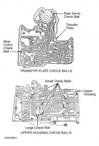

I am putting the valve body back together and I found a small steel ball in the pan I drained fluid in. I dint see it come out during disassembly. I don't see where it goes. I dint think that this transmission had check balls. Can you check and see? It is a 46RE, thanks
Oct 26, 2010 at 9:06 AM
DOCFIXIT
  • 18,828 POSTS
See diagram ues a dab of Vasoline to hold in position
https://images.2carpros.com/forum/automotive_pictures/198357_Graphic_674.jpg
