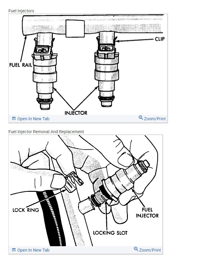

i keep getting this code and it erases easy. this is what i have doe to the truck
i have changed the spark plugs, wires, distributor cap, distributor.
what i have seen, when i tow a trailer the light goes away, when i clean the fuel injection (stp) the goes away for about a day.
the engine does not shack or the act like it is missing a cylinder when on.
any ideals?

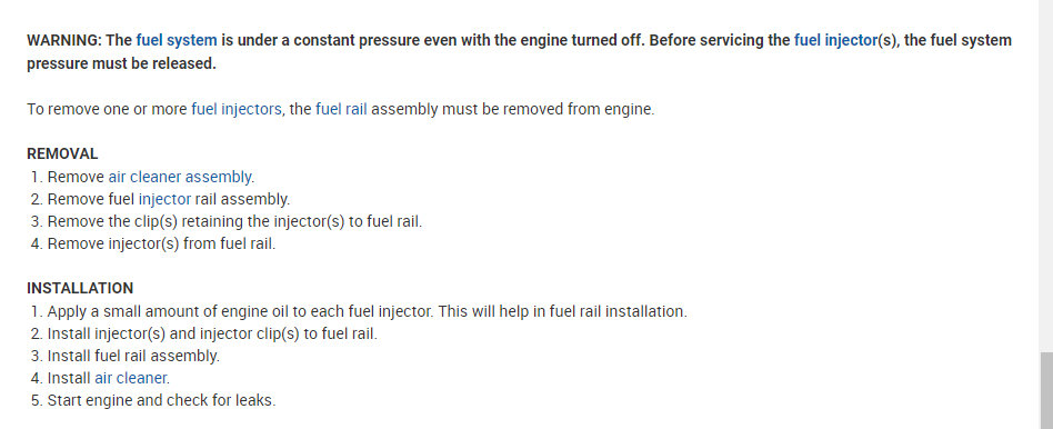

More than likely you have a leaking injector. We can confirm this by checking the o2 sensor voltage and seeing if it is rich on that bank but based on what you are seeing I would go ahead and replace that injector.
Here are a couple guides that talk about this issue and give more detail on possible causes:
https://www.2carpros.com/articles/how-to-test-a-fuel-injector
However, due to what you are seeing with the fuel cleaner and added load the misfire goes away, that is pointing directly to an injector issue.
Here is a guide that will help with replacing it:
https://www.2carpros.com/articles/how-to-replace-a-fuel-injector
Below is the process from the manual on how to replace the injectors. Please let us know if you have other questions. Thanks
