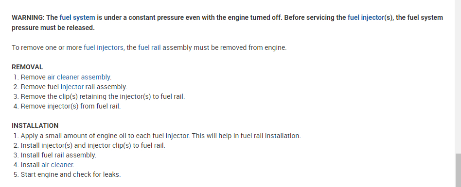

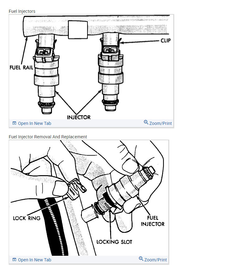

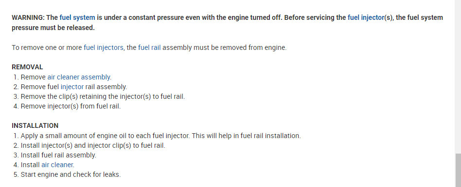

Here is a guide that will help with replacing it:
https://www.2carpros.com/articles/how-to-replace-a-fuel-injector
Below is the process from the manual on how to replace the injectors. Please let us know if you have other questions. Thanks
