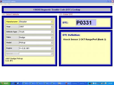

I recently had my 360 engine rebuilt for performance by stroking it to a 408. Ever since the rebuild I have been throwing P0331 computer code. What could be causing this?

See below

I see you attached a screen shot of a diagnostic tool showing P0331 code, however this does not answer my question about what could be causing the code to be thrown?

That code applies to the knock sensor its job is to retard the ignition timing when the engine starts to detonate/ping-

Understood, however I called the dealership and 1997 dodge ram 2500 does not have a knock sensor?

I was just fixing to tell you that-after looking over in the Mitchell1 auto references it shouldn't give that code-try clearing it again and see what happens-
I've puilled that code in my scantool which I installed into my PC for quick references-
