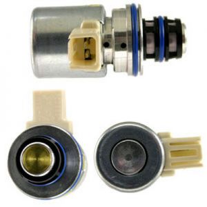

Hey I changed the filter and transmission fluid and it started working it go in reverse and in drive but it wont shift when acclerating it go all the way up to 5000rpm before it shifts down to 4000 rpms

  • 109,872 POSTS
That sounds like a bad shift solenoid.

Hey that shift solenoid I went to look up the part on oriellys auto parts and it keeps giving me an auto trans control solenoid so if you know of a place I can get it that would be gratful

  • 109,872 POSTS
I believe that is just another name for the same thing. Here is a picture of the part. Check it out and compare what they are showing you.
