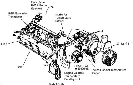

Hi I was wondering where the IAT senor would be located on my 97 Dodge ram 1500 5.9l v8, if you had a picture that would be a huge help, thanks

Your vehicle's IAT sensor should be located in the right front side of the intake manifold..

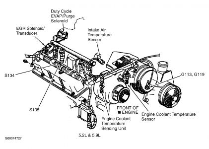

Thanks for your help, do u have the link or a bigger picture of what you have posted? Thanks

No link, that's not big enough?? if below isn't big enough then give me your email addy and i can email it to you, then you can blow it up bigger.
