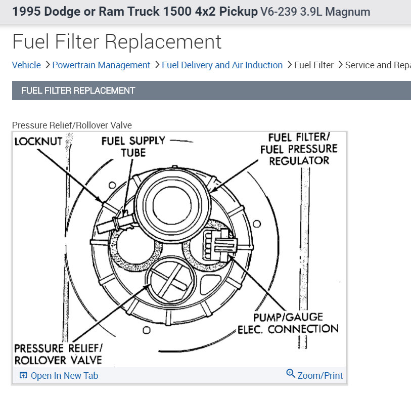

is there two fuel pumps? if so where is the second one located?
Nov 3, 2010 at 12:23 PM
  • 55,594 POSTS

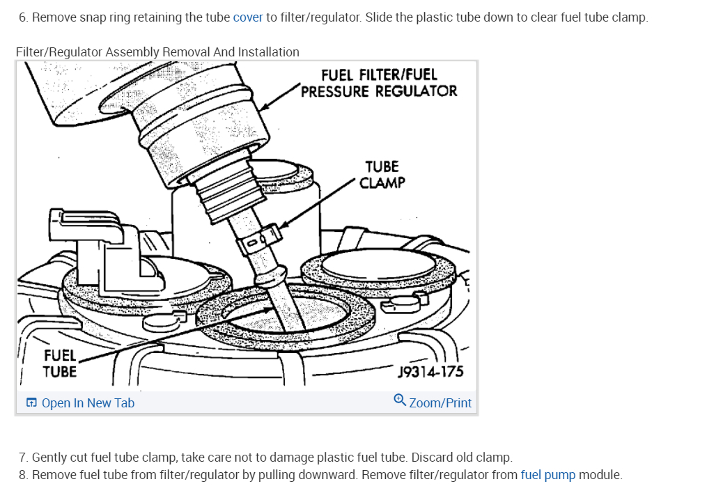

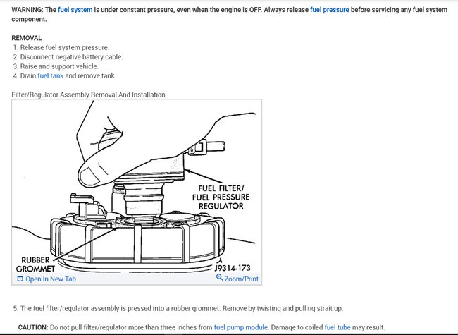

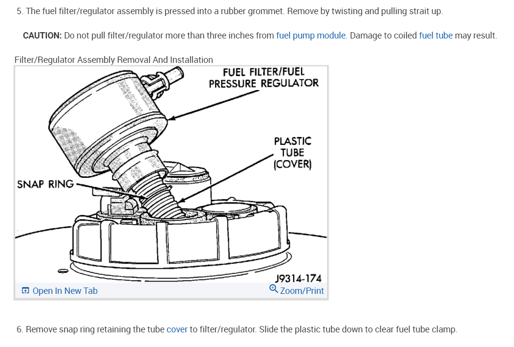

There is only one pump per tank. here are the instructions on how to change it out which shows the location of the pump as well. Check out the diagrams (below). Please let us know if you need anything else to get the problem fixed.
