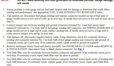

fuel gauge is stuck on full. used a modis scan tool to locate problem and had a tranny shop hook up there scan tool but no fault codes found. hammered fuel tank with rubber mallot tosee if floater was stuck, nothing happened. narowed it down to wire problems, ground, sensor in tank, or the cluster. can someone help me out. this problem is really getting in the way other work on this truck

Found this info for analog gage cluster.
https://images.2carpros.com/forum/automotive_pictures/512072_dodge_pickup_fuel_gage_1.jpg
