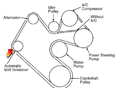

I am replacing the water pump and I need to know how to take off the fan belt.

There is a tensioner that holds the tension on the belt. Using a socket and a wrench, you can release the tension at the nut on the pulley, so you can slip the belt off.
https://www.2carpros.com/forum/automotive_pictures/30961_rambelt_1.jpg
