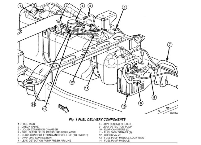

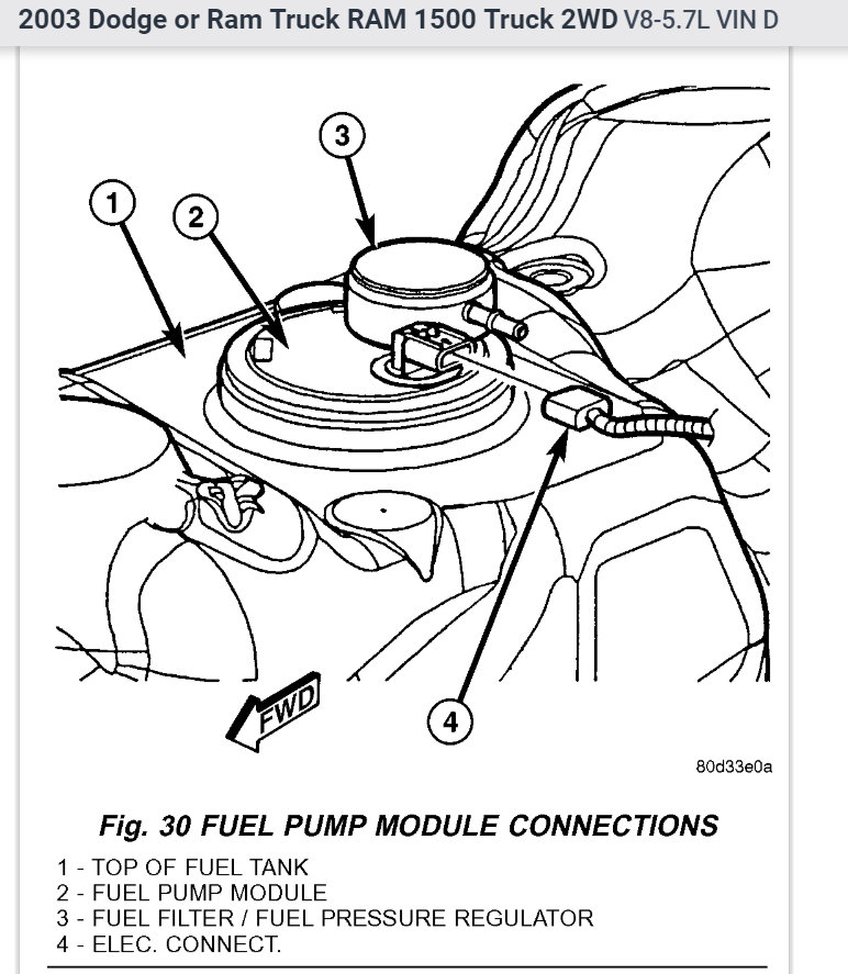

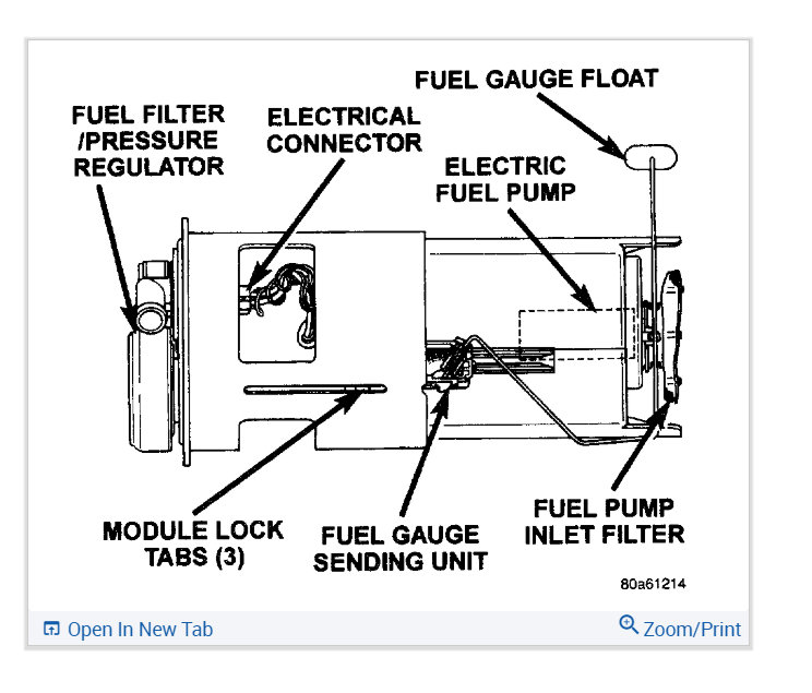

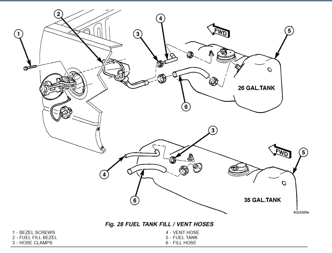

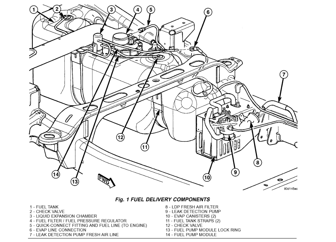

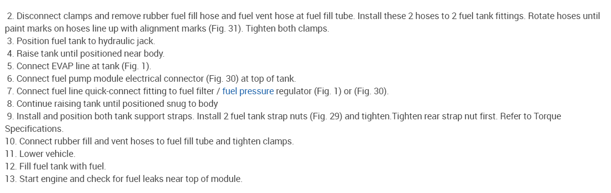

My truck starts, and idles, roughly. Then when I step on the gas or open the throttle it bogs down really bad and dies. Can anybody help me with this?
Saturday, August 29th, 2009 AT 11:32 AM
KEN L
  • MASTER CERTIFIED MECHANIC
  • 48,363 POSTS

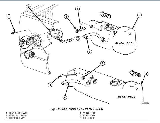

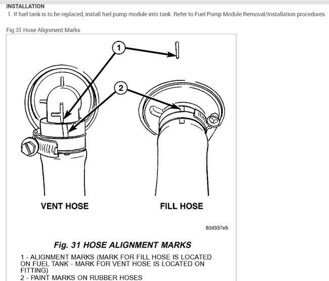

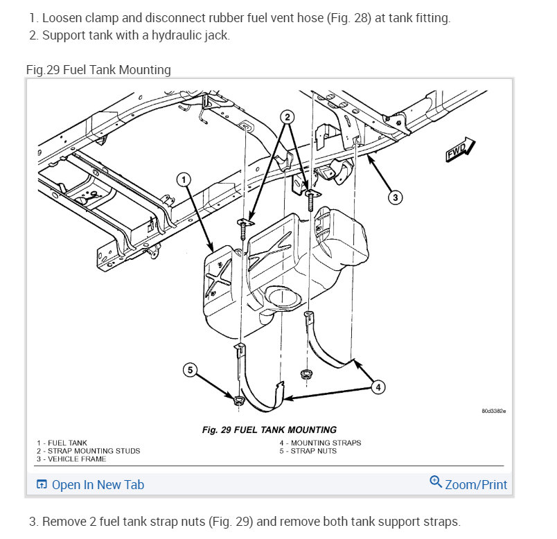

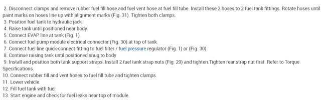

This sounds like you have a clogged exhaust system or a weak fuel pump. here are two guides to help us see which one it is with instructions to change the fuel pump out in the diagrams below:
and
