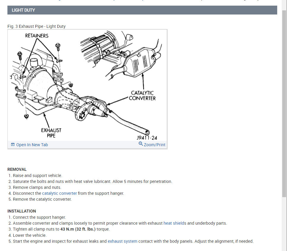

What can cause you not to hear the exhaust when the truck is running and also cause it to cut off

This sounds like a converter issue. Here are a number of guides that will help with explaining this, how to test it, and how to replace it:
https://www.2carpros.com/articles/catalytic-converter-replacement
Please see the attached info from the manual that will show how to replace the converter.
Please run through this info and let us know if you have questions. Thanks
