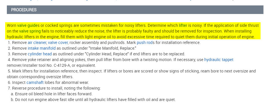

95V10ONETON
I am having this same exact issue with my 1995 v10 3500 club cab off road. Trucks only got 110,000 and this is driving me insane. What did you ever discover it was? Really hoping for an answer this made my night been searching for months.
Apr 6, 2020 at 1:02 PM
Okay. Have you made any repairs on this issue? Most likely this is a lifter noise but please see the attachment as valve guides or spring issues can cause very similar noises.
Can you get a recording of the noise and I can take a listen to it and we can go from there? Plus let me know what you have done so far and we can figure this out. Thanks
