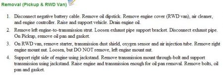

I have lost oil pressure in my 1995 dodge ram 1500 3.9 liter. I changed oil and filter and didnt help. I was old by a mechanic that they have to pull engine to drop the oil pan and change pump, and that it would be 500 dollars. I was wondering if this is true. I cant imagine that you have to pull a motor to drop oil pan. Can you help me with this.

Hi there,
Looking at Mitchell 1 there is a way to remove the sump with out removing the engine, there is a bit of work involved but i would think it is quicker that taking the engine out, see text...
