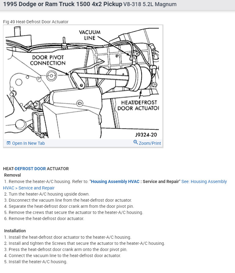

The blower works but there is no heat coming out. The engin is not over heating. The gage appears to be working. What could be the problem?
Feb 13, 2008 at 1:11 PM
SQM
  • 6,383 POSTS
If the fan is blowing but you are only getting cool air, then it could be due to a faulty blend door actuator.
The blend door actuator controls the hot or cool air flow. Over time the actuator can malfunction and fail. Typically, when that actuator fails it will fail at either hot or cold side.
It is located under the dash in the HVAC panel.
