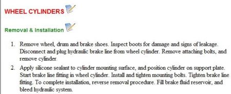

1994 Dodge Ram replacing rear wheel cylinder
1994 DODGE RAM
94,000 MILES • V8 • 2WD • AUTOMATIC
DERRICKMAN1978
instructions to replace rear wheel cylinder.
