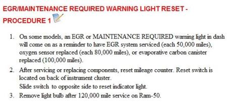

how to reset maintenance lite
Jun 30, 2010 at 2:34 AM
BLUELIGHTNIN6
  • 16,542 POSTS
https://images.2carpros.com/forum/automotive_pictures/261618_Noname_2411.jpg
