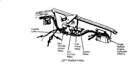

where is the distributor control module on a 89 dodge ram pick up
Oct 6, 2009 at 6:46 AM
DOCFIXIT
  • 18,828 POSTS
SECM is on left fender
https://images.2carpros.com/forum/automotive_pictures/198357_Grafic_3_48.jpg
