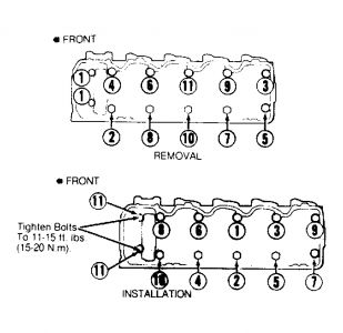

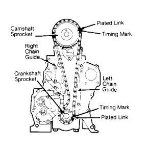

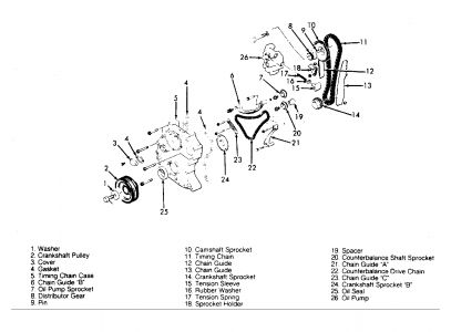

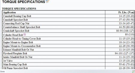

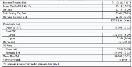

I need the torque for the main bearings and also the Rod bearings and the cyliners head torque. Also if you know where I can get a print out of the timing marks. I am rebuilding an engine and need this to finish it.

https://images.2carpros.com/forum/automotive_pictures/62217_Specsa_1.jpg
https://images.2carpros.com/forum/automotive_pictures/62217_Specsb_1.jpg
https://images.2carpros.com/forum/automotive_pictures/62217_Sequ_1.jpg
https://images.2carpros.com/forum/automotive_pictures/62217_Timing_Mark26_1.jpg

https://images.2carpros.com/forum/automotive_pictures/62217_Explode_1.jpg
