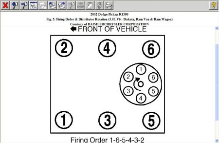

2002 dodge 1500, 3.9L - need firing order for tune-up.

There you go
https://images.2carpros.com/forum/automotive_pictures/12900_3_4.jpg
