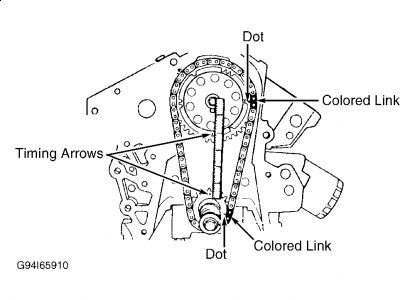

What is the camshaft tightenig sequence for a 2001 Dodge Grand Caravan?

Hi there, According to your model specs, Mitchell 1 advises that there is no cam tightening sequence, this is a block mounted cam and the thrust plate is torqued to 12Nm.
