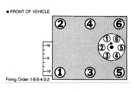

I need to know the firing order for a 1994 dodge B-250 van with a 3.9L V-6 fuel injected. I need to know the order in rotation for the block and distributor.

Hi there,
Firing order and dist rotation as per pic.
