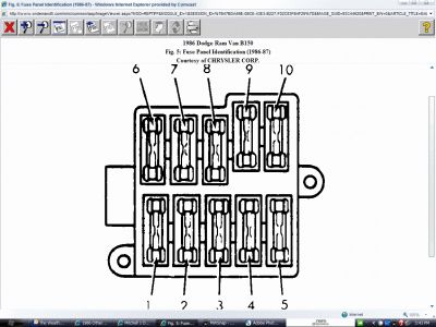

Diagram of fuse B
1986 DODGE
KIMBODETT
Dodge Ram Van

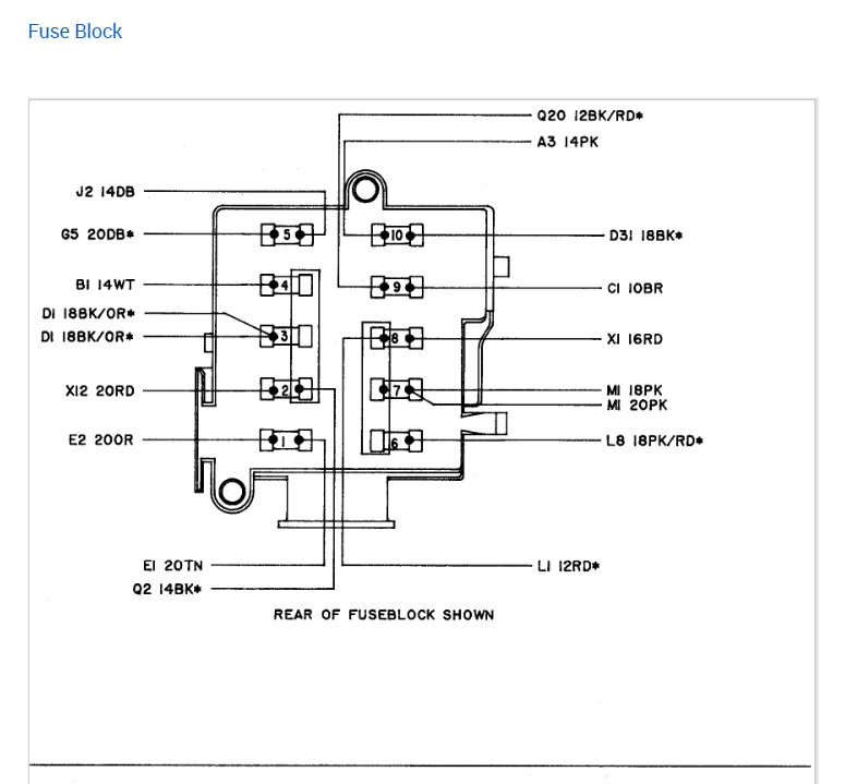

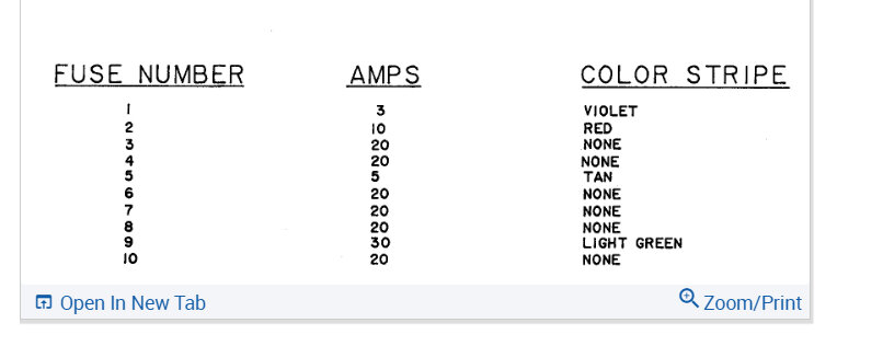

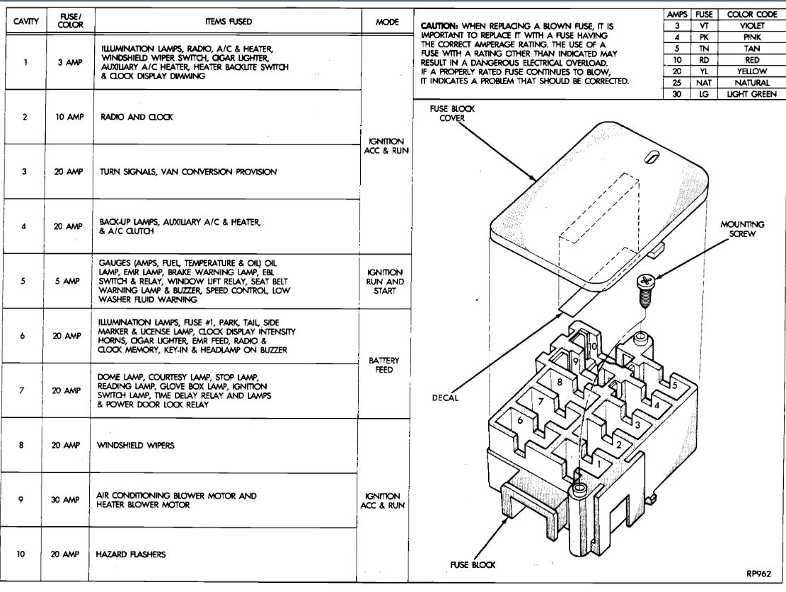

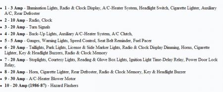

I need the diagram to check and see where all the fuses go, along with voltage of the fuses.
May 1, 2008 at 7:38 AM
MERLIN2021
  • 17,250 POSTS
Here are the fuse location and a guide to help test them, please check out the images below https://www.2carpros.com/articles/how-to-check-a-car-fuse
https://images.2carpros.com/forum/automotive_pictures/62217_Fusesa_1.jpg
https://images.2carpros.com/forum/automotive_pictures/62217_Fusesb_1.jpg
Check out the images (Below). Please let us know how it goes
